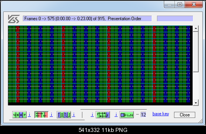

    Yes, the same video. I remuxed the video into an MPG container then used GSpot's GOP structure viewer:
    Presentation order:
    You can see that the video starts with 2 b frames (green boxes).

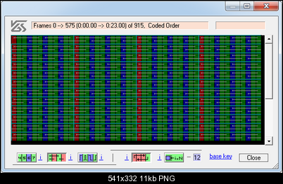

    Stored order:
    Here you can see that those two b frames are stored after the first i frame. That's because the I frame has to be decoded (along with the last p frame of the previous GOP) before the two b frames can be decoded.
    Some decoders will skip those two leading b frames, some will return garbage or some other unpredictable frame.

    For experiment: installing "matrox VFW mpeg 2 I frame HD" I can import and edit perfect the clip generated with this mpeg2codec but they have the good quality of FFmpeg. Matrox mpeg2 use only the VFW way: vidc.M701=mvcVfwMpeg2HD.dll
    Teorically I can use matrox mpeg 2... but if I have to turn the world go trough a re-encoding pass I keep the dear old damn mjpeg
    Only it was funny the idea of being able to edit the native clip (-vcodec copy)
    Hoewver I think the problem is in FFdshow or in encoding process or I don' know

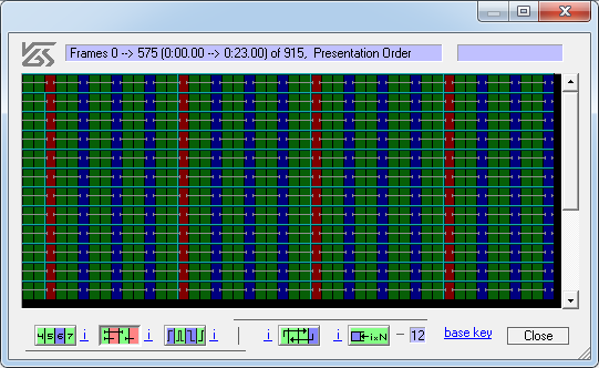

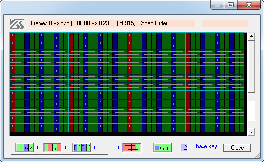

  27. I can confirm problem is MPEG2 VFW decoder of ffdshow.
    Other I-frame formats don't have the problem e.g. ffv1 , uncompressed, ut video - so that rules out a decoding issue with ffmpeg before encoding . I don't know why ffdshow vfw mpeg2 decoder has this issue with I-frame formats, it shouldn't
    (It doesn't make a difference here in terms of scrubbing - but you should be encoding interlaced as mentioned above)
