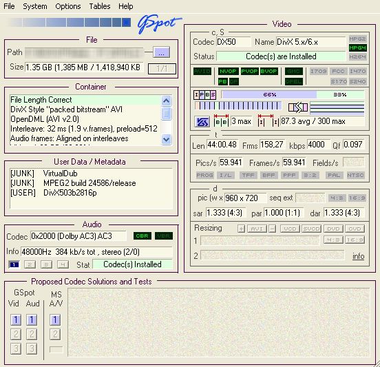

  8. I know all of that, that's why I'm asking, because this is a non-compliant file.
    I enclose a screencap of GSpot, as far as I can see the audio is a perfectly compliant AC3.
    Just to be clear, I am not trying to author a DVD, I just need a file my stand-alone player is capable of dealing with.

  9. Why is it so hard? Just reencode at half the framerate (SelectEven in AviSynth) and the lower resolution (LanczosResize(640,480) in AviSynth). It can also be done entirely in VDub.

    And by the way: you're putting yourself through extra work by making a screen capture of info that could have been copied as plain text from MediaInfo's "Text View" and would contain more data than GSpot delivers. But thanks anyway for submitting.
