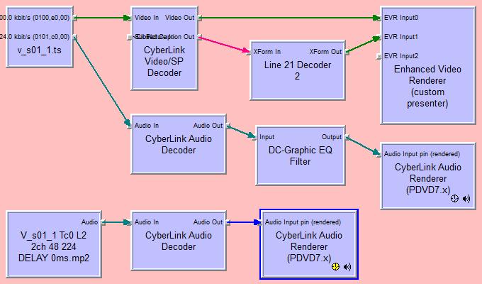

    Ok, I have identified the cause of the problem. Have a look at the attached v_s01_1a.jpg file. This is a graph of v_s01_1.ts being played using some cyberlink external filters in mpc-hc. The upper part of the graph looks sane and would play, but there is an additional unwanted instance of the mp2 audio track in the lower part of the graph. mpc-hc is in fact trying to play two instances of the same audio track! I can confirm that the source ts only contains one video track and one audio track. If the external filters are disabled, things become even more bizarre and an audio switcher gets added to the chain - see attached v_s01_1b.jpg. So it looks as if the player/cutter can't correctly identify what is in the ts container.
    I have also tried the latest version of tsMuxeR and the resulting ts does play in mpc-hc, but I can't seek when using SmartCutter.
    Thanks El Heggunte for the additional FFmpeg options, I will generate a new file and get back to you tomorrow.

    BTW, what is the source filter that was being used for demultiplexing the TS file
    Regarding the Cyberlink filters, I use only the MPEG-2 decoder, and configure MPC-HC to block both "Line 21 decoders ".

  8. Originally Posted by w2kpro View Post
    That is a feature of MPCHC. It will play an audio track with the same base name as the video track. You can disable it with View -> Options -> Playback -> Auto-load Audio Files.

    I think the ts file is being split by mpc-hc's internal filter, but AV Filter is registered on the system. I use the Cyberlink filter because I can adjust the brightness and contrast of the video. The problem is not with mpc-hc's settings or the external filters, as it plays dvb-t ts recordings without any problems.
    I muxed a test clip using the additional parameters and when the ts file was played I got a sane filter graph with no additional mp2 stream. However, if the "-fflags genpts" or "-fflags 1" option is removed, a "set first pts" error occurs. I am not sure what the correct solution to setting "-first_pts" flag is as it requires an Int64 value. Although the new ts file plays using mpc-hc, it can't be edited in SmartCutter. SmartCutter will only load and play the file, but it is not possible to seek to any given position in the clip or frame step, so there is still something fundamentally wrong with the container.
