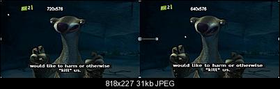

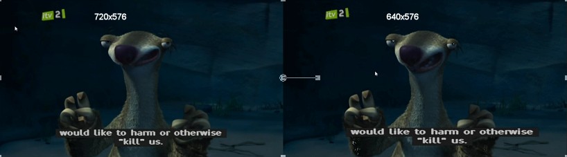

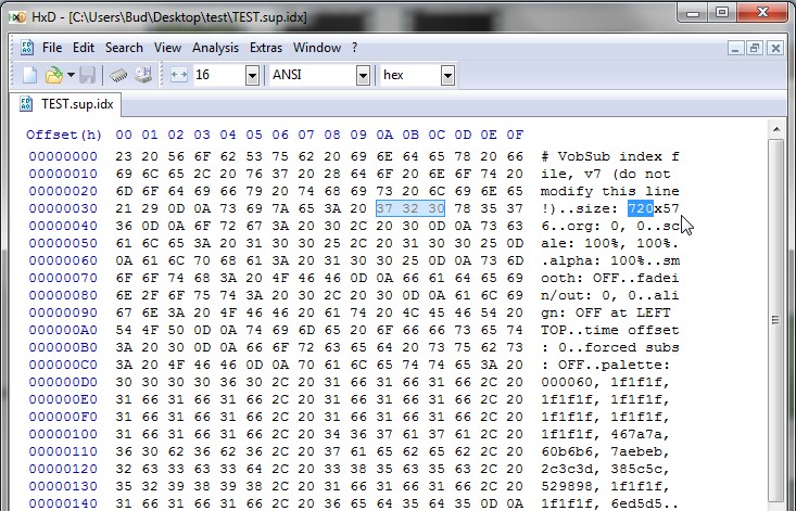

    If you are using an SUP/IDX file make sure the resolution in the IDX is set the same as the video. You subtitles characters are not just misaligned they are wider by .88 times, in the original. This will be exactly how they turn out if the resolution is set to 640 instead of 720 like your video.

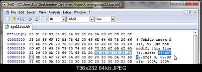

    Use a Hex editor to check the IDX file.

    The easiest way is to just change the IDX file with a hex editor (I use HxD). The example I posted above shows 640x480. Just open the IDX with the HxD editor and position your cursor in the RIGHT HAND area and changed the 640 to 720. That's all I did to make the 2 examples, one correct and one large. Offsetting, as suggested above, will work but only for a particular line.
    since the font matrix is wider than it should be.
    Are you sure about the dimensions because the subtitles are actually too fat which is usually what results when the subtitles think there is only 640 pixel width? Its like changuing your display resolution from 1920 to 640. everything gets real large including the fonts.
    MAKE COPIES FIRST:
    Try changing the IDX file and test it, both larger and smaller width than the current. It should alter the font width and starting position but try to keep within the modulus 16 range (640, 720, 800, etc)

    I will try to clarify my answer earlier. When subtitle (SSA, IDX, etc) are set to say 640x480, it is as if they will be painted on a screen that is 640x480. Now if the size and position is correct but the video is, say 720x480 then the subtitles are 'stretched' to cover the larger video. So, each pixel of the 640x480 subtitle screen becomes in essence 1.125 pixels (720/640) wide. This includes the spaces at the left of the line of subtitles and causes the subtitle line to 'Look' like it is farther right.
    In my example I posted above, you can see the same line of text is farther right and the font stretched wider in the 640x576 example than the 720x576 example. The line is also offset to the right because of this.
    Manono, you are right in that if the subtitles are indeed 720x??? and the video is 640x??? then the reverse is true and the subtitles will in essence be 'Squeezed' together and move farther right, in effect. That is why I asked if the dimensions were maybe reversed since the example that was submitted looked exactly like the opposite was true.

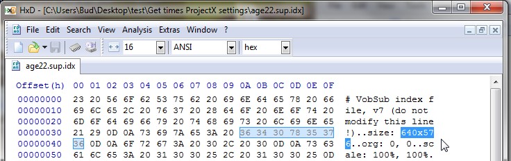

    As far as the HxD (hex editor) is concerned, you just open the editor, drag a file to it and it shows you the hex representation on the left and the text representation on the right. You can place you mouse on the left and change the hex characters if you know what they are OR on the right and just change the text (Type over the 640 and make it 720, SAME number of characters so no problems). Then click file -> save/save as and it prompts you that it is changing the file and automatically makes a backup of the original. Now you have a file with 720x480 subtitles.

    Sorry for the delay but I think I finally found the problem for anyone following this thread. It is possible to modify the Size, Origin x,y , Alignment, scale, etc of the VOBSubs directly within the MKV file but Handbrake does not seem to honor the settings. This is further messed up if the video has dimensions/resolutions that are such as 704x368 with an anamorphic (I believe that's the term) aspect of 2.35 which displays as 864x368.
    I double checked with Format Factory, VirtualDub and PotPlayer via AVISYNTH input to them, and they all show the subtitles correctly as per the IDX settings within the MKV file. If anyone wishes to use this method for using VOBSUBs in another editor converter, or for information only, this is the Method I used:

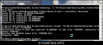

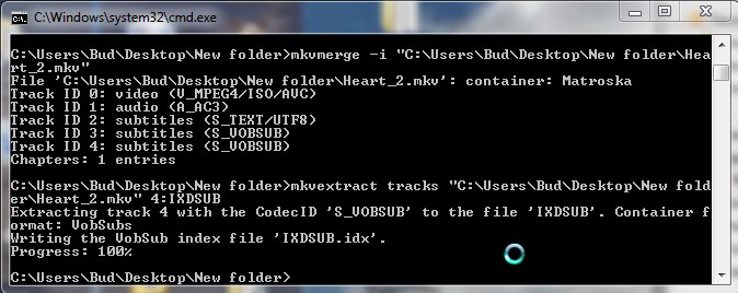

    1. Use MKVMerge to get the Track ID and Use MKVExtract to extract the IDX/SUB files for use with AVISynth:

    3. AFTER MAKING A COPY OF YOUR MKV and storing for safekeeping, Use HxD to search for text such as "size" to locate IDX area within the MKV as shown in my previous post #14 and change necessary items explained below .
    # Settings
    # Original frame size
    # Origin, relative to the upper-left corner, can be overloaded by aligment
    org: 0, 0 Can be altered to x, y such as 0, 10 for upper left. Need to Change Alignment OFF at LEFT UPPER --> ON at LEFT UPPER. Use Insert for extra digits
    # Image scaling (hor,ver), origin is at the upper-left corner or at the alignment coord (x, y)
    scale: 100%, 100% Keep at 3 digits such as 080%
    # Alpha blending
    alpha: 100%
    # Smoothing for very blocky images (use OLD for no filtering)
    smooth: OFF
    # In millisecs
    fadein/out: 50, 50
    # Force subtitle placement relative to (org.x, org.y)
    align: OFF at LEFT TOP Change to ON to honor Origin above. Use Delete key to remove extra "F"
    # For correcting non-progressive desync. (in millisecs or hh:mms:ms)
    # Note: Not effective in DirectVobSub, use "delay: ... " instead.
    time offset: 0
    # ON: displays only forced subtitles, OFF: shows everything
    forced subs: OFF
    # The original palette of the DVD
    palette: 000000, 7e7e7e, fbff8b, cb86f1, 7f74b8, e23f06, 0a48ea, b3d65a, 6b92f1, 87f087, c02081, f8d0f4, e3c411, 382201, e8840b, fdfdfd
    AFAIK Unknown,Background color,text smoothing color,1st Text Color, Unknown,Background color, text smoothing color,2nd Text Color...
    # Custom colors (transp idxs and the four colors)
    custom colors: OFF, tridx: 0000, colors: 000000, 000000, 000000, 000000
    AFAIK scheme same as above
    # Language index in use
    langidx: 0
    # English
    id: en, index: 0 May also be eng, jpn, etc
    # Decomment next line to activate alternative name in DirectVobSub / Windows Media Player 6.x
    # alt: English
    # Vob/Cell ID: 1, 1 (PTS: 0)
    timestamp: 00:00:01:101, filepos: 000000000 Timestamp for Subtitle 1 to show up
    timestamp: 00:00:08:708, filepos: 000001000 Timestamp for Subtitle 2 to show up
    For anyone that does not understand any or all of the above, I apologize for wasting anyone's time but I found no method to make HandBrake honor IDX stings or correct for other needed settings. I thought it may come in handy for others that are familiar with AVISynth and IDX files to use other programs to embed VOB subtitles via AVISynth It is also possible to use this to alter the timestamps to sync the subtitles.
