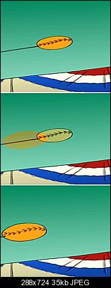

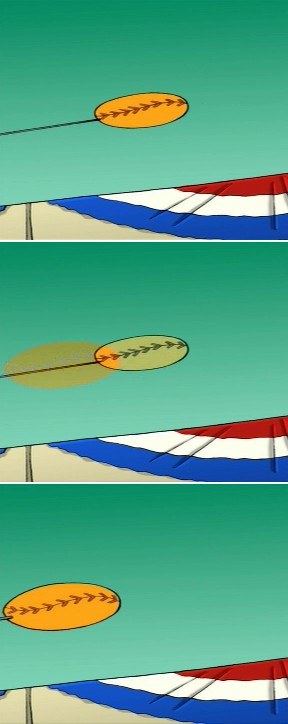

  14. That's in sad shape. It looks like someone tried to inverse telecine to 23.976 fps but it didn't work properly, leaving some combed frames. Then they duplicated frames to restore the 29.97 fps frame rate. Sometimes the combed frames are duplicated. Since it is encoded progressive the interlaced chroma channels have blended together. Here's one field from a sequence of frames. The top and bottom images are from fields where the original frame was progressive, the middle field is from an interlaced frame encoded progressive:
    You can see that the middle field has a blend of the colors of the two other fields.
