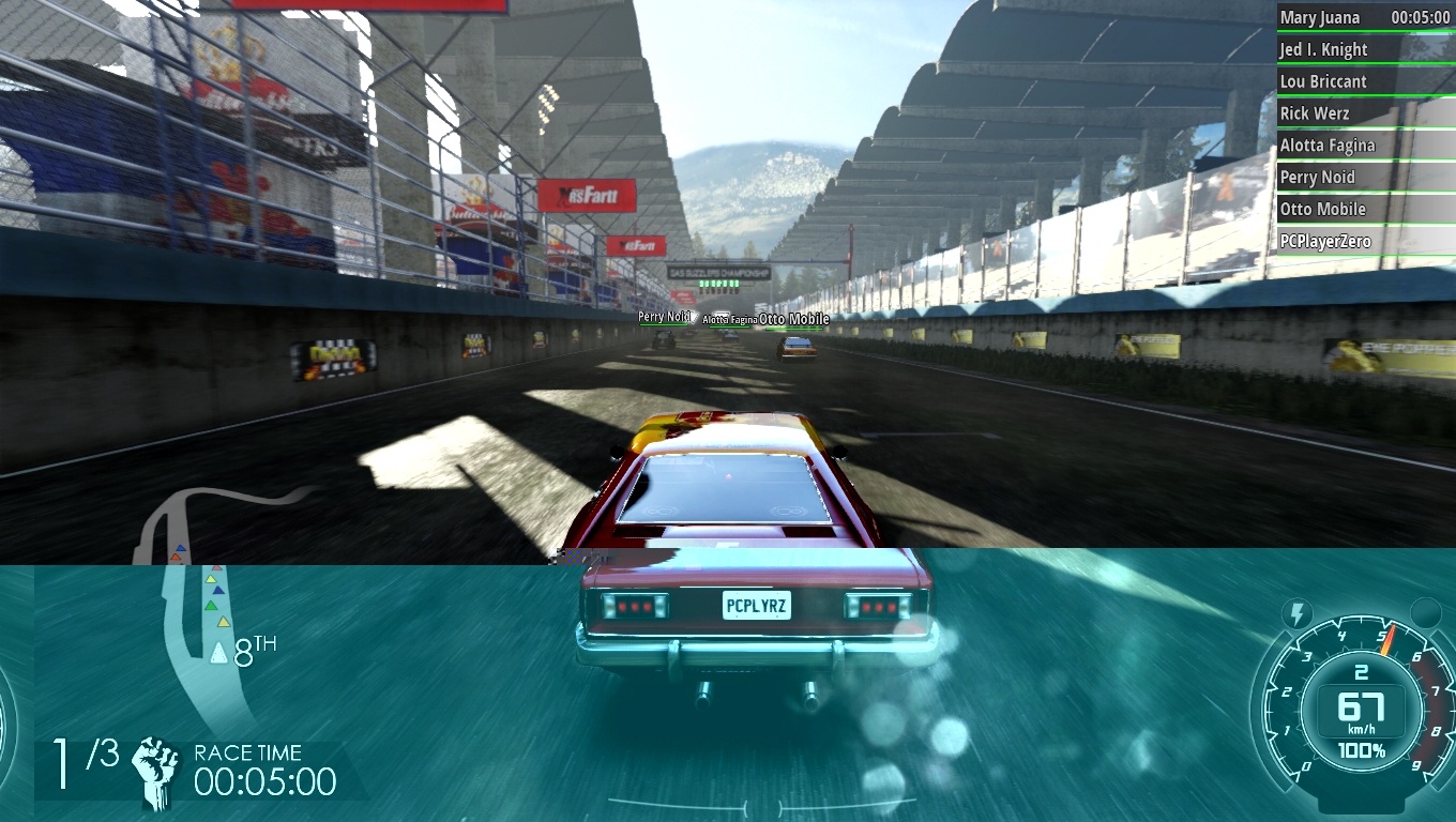

    I record gameplay with MSI afteburner and then edit it using virtualdub. My videocard is geforce 570. The problem is that sometimes usually on very bright frames i get a different color usually at the bottom of the video. The different color can be varied, like yellow, green or blue. I tried to use some virtualdub cleaning filters but it didn't do anything. Maybe i'm using the filters with wrong settings. It happens in many games. See attachment. If someone could provide an indication of a filter and if possible what setting to use it would be great.
    I know how to take out bad frames manually but this procedure is very upsetting and time consuming depending on the number of bad frames, so i want an automated solution.
    Thanks in advance.
Name:	gasguzzlers bad color0001.jpeg

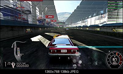

  4. This comes pretty close with the sample image.
    ImageSource("gasguzzlers bad color0001.jpg", start=0, end=23, fps=23.976)
    top=Crop(0,0,-0,528)
    bot=Crop(0,528,-0,-0).RGBAdjust(gb=-78, bb=-82)
    StackVertical(top, bot)

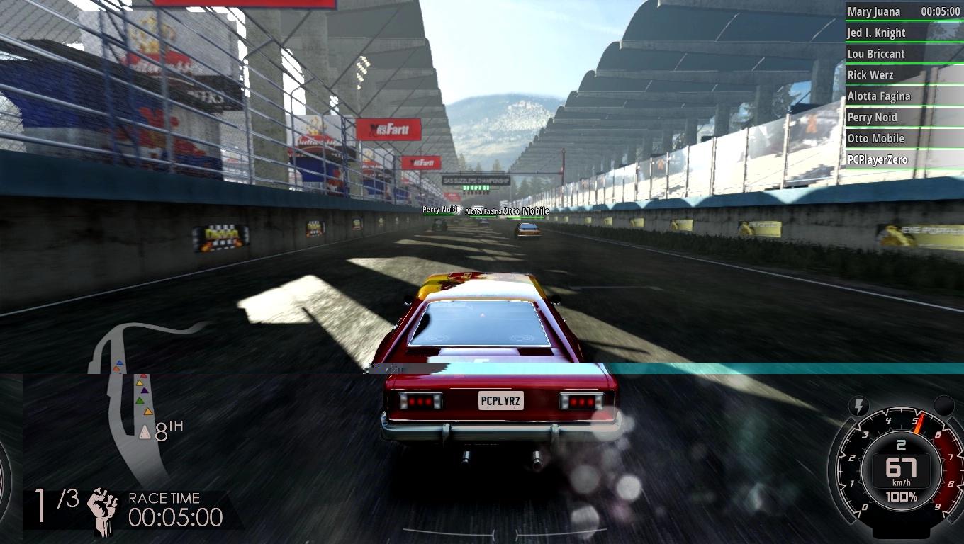

    Of course, the "tear" is at a different height on the left and right parts of the image. So you'll need more complex cutting and stacking. If the tear moves from frame to frame you're screwed. And there's still the issue of the bottom part of the frame coming from a different source frame.
