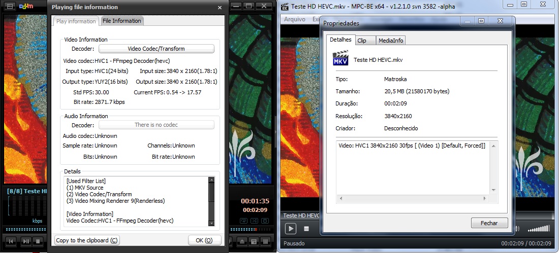

    Taking advantage of this new support for Hevc, tested it to the extreme, where one coded sample of 3840x2160 via Hybrid and compared with the player MPC-BE 64Bit (1.2.1.0 - Build 3582 - MSVC 2010 SP1), and obtained the following results with DivX265 :
    PotPlayer worked fine, no crashes or Slags.
    MPC-BE rotated but began to catch every second of the sample. (Test no external filters).

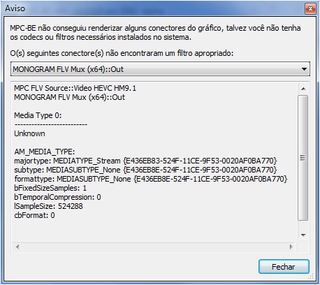

    PS: MPC-BE is a very good player and powerful, only for heavy files like this, WITH RESOLUTIONS UP TO 2560X1600 - limit the player, there is still a few tweaks to run cool.
    Test yourself with my sample 3840x2160 (20,1mb): https://shared.com/mqognh9v8x

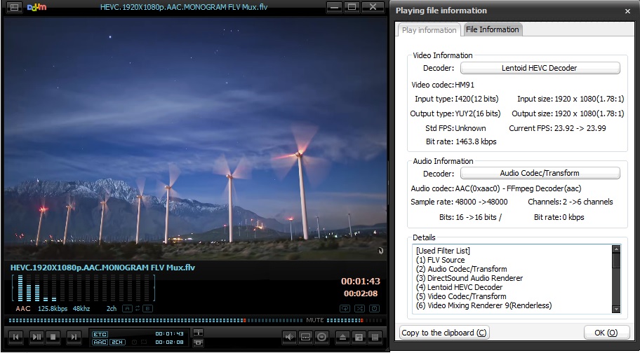

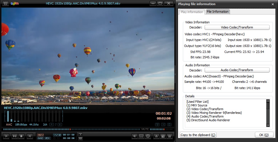

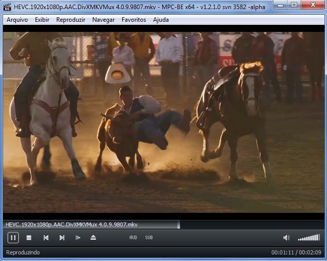

    2 more videos converted samples (1920x1080) for testing:
    https://shared.com/wk98d14024 - HEVC.1920X1080p.AAC.MONOGRAM FLV Mux
    https://shared.com/nrqjngjbup - HEVC.1920x1080p.AAC.DivXMKVMux 4.0.9.9807
    The two files above usually rolled in PotPlayer
    The MPC-BE only failed to run HEVC.1920X1080p.AAC.MONOGRAM FLV Mux.
