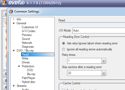

  7. Originally Posted by cyflyer View Post
    I don't think there is a setting for setting the retry counts.
    Yes there is:
    Start DVD Fab before inserting the disc in the drive. And hold down a shift key while closing the door, and continue holding it down until the drive stops spinning. That will keep Windows' Auto Insert Notification from doing much with the disc.

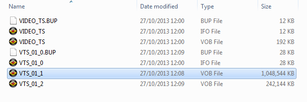

    Well halleluya, I had given up, nothing was working, DvdFab wasn't doing anything (and I didn't have the patience to try for 5 hours), I gave Ripit4me a try and the resultant 1.23GB file ripped to my computer after a couple of tries. It worked where everything else failed. How is it Ripit4me with dvddecrypter works when dvddecrypter on its own does not work, I'll not understand, but I'm sure someone with better understanding will explain it. Anyway, I have the following files (in screenshot), the larger VTS_01_1 plays through ok when opened in Mediaplayer, but its not dvd compliant as powerdvd or dvdshrink will not play. How do I get it back to a dvd compliant form ?

    ... but its not dvd compliant as powerdvd or dvdshrink will not play. How do I get it back to a dvd compliant form ?
    Good for you! The reason powerdvd won't play it is that you're missing the IFO files. Just copy the 2 BUP files and change the extension to IFO; BUP is a backup of IFO.
    You may have to go to Folder Options in Windows Control Panel and remove the check mark in the "Hide extensions for known file types" box.
    that won't work the ifo files are there. you just missed them because the extensions are hidden but listed if you look carefully.
  20. Damn, you're right! Then the easiest way to make this disc play normally is to re-generate the IFO's with IFOedit. Just make sure to work with copies of your files.

    nic2k4, I raise my hat to you and thank you ! You suggestion with IFOedit worked just great, and I have a fully working and compliant dvd. Phew !
    So from throw in the bin, wasted nausia inducing (and beleive me it does) staring into camcorder chopper ride, to watchable dvd, Ripit4me- IFOedit worked. Thanks to the other suggestions also, roma_turok, I went with nics' route initially because it seemed like a one step, one program route, whereas yours seemed like another three more downloads, also DVDVob2Mpg was warning of adware downloads attached to it, which I was in no mood to deal with, but still your help was appreciated. Also worth noteing, when I tried burning the dvd files in Nero, it gave an error "relocation of files failed" but I read somewhere that its because some files had different dates on them, so after passing it through Shrink, and burning that file, it cured that.
