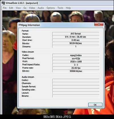

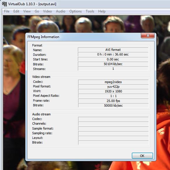

The ffmpeg source plugin for VirtualDub works fine with your video here. It shows it's using the mpeg 2 decoder.
