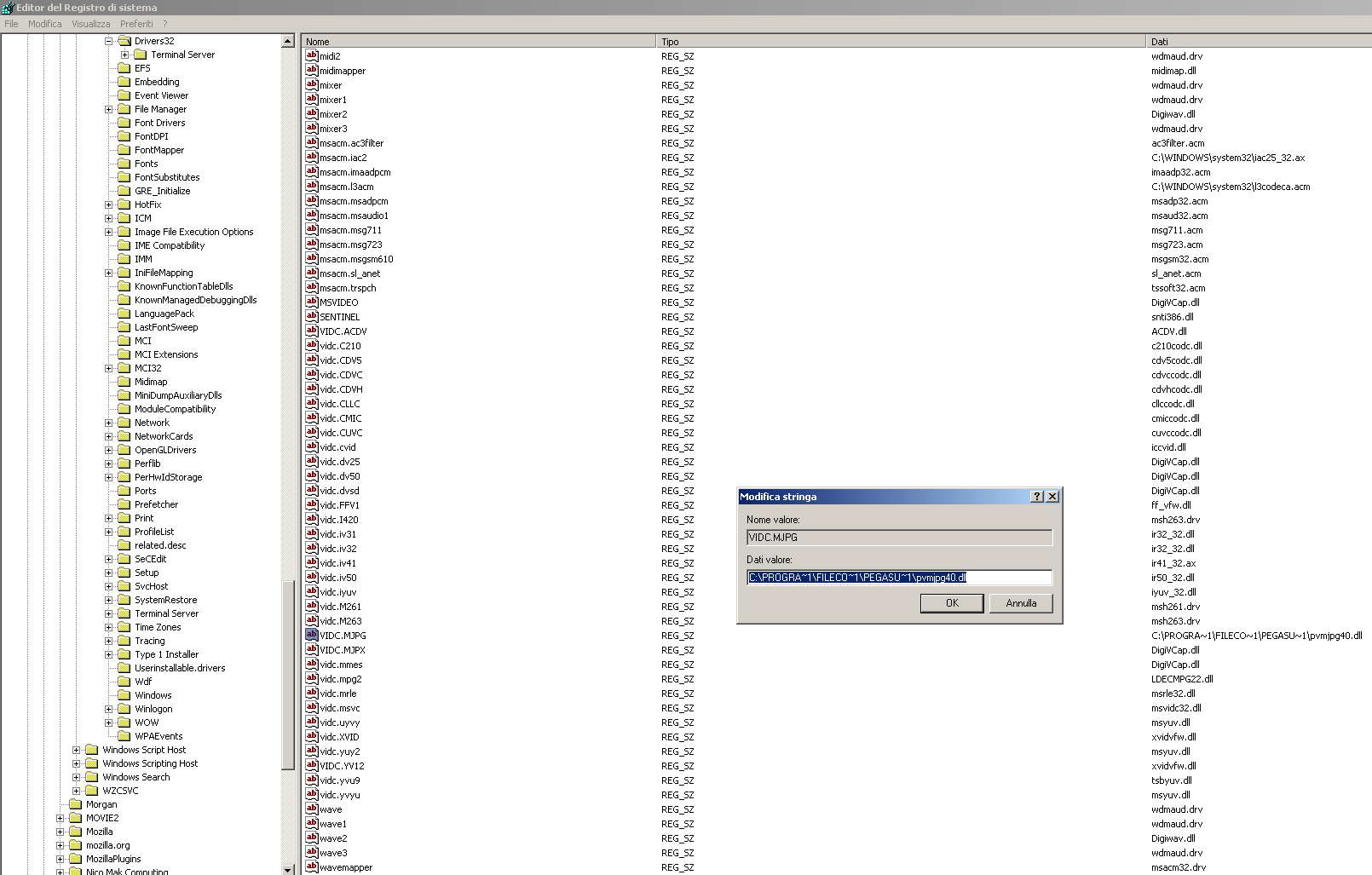

    I discovered that my nle (in sync blade 2.2) has a backdoor that can take video from an external source based on the configuration of the register into position
    HKEY_LOCAL_MACHINE \ SOFTWARE \ Microsoft \ Windows NT \ CurrentVersion \ Drivers32
    for example vidc.mjpg gives a chance to read the files that have vtag " MJPG " from the codec vfw pvmjpg40.dll ( PIC MJPEG )
    (http://www.lwks.com/index.php?option=com_kunena&func=view&catid=27&id=4266&Itemid=81)

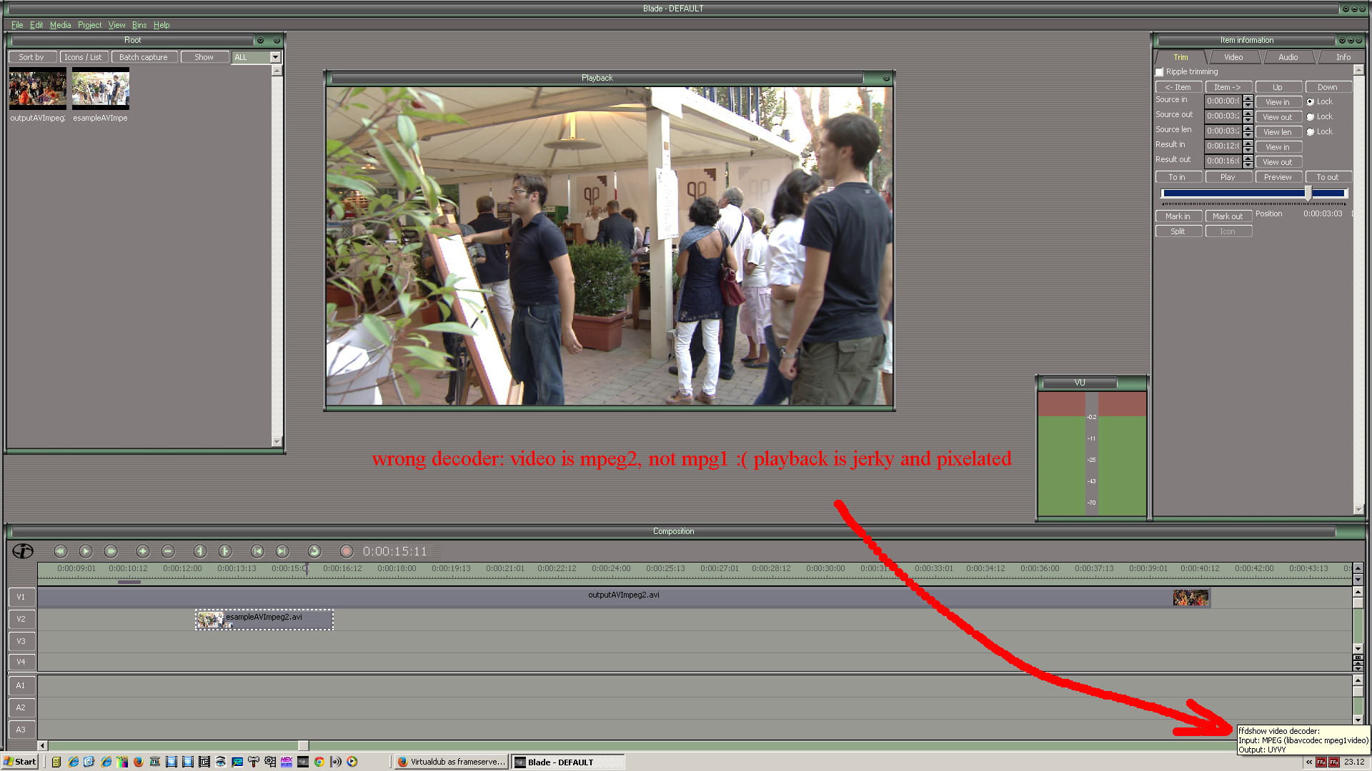

    but I would like to import files natively . MPG2 ( I attach here an example. avi) without transcoding mjpg. And then I submitted manually an entry vidc.mpg2 = ff_vfw.dll I previously have installed and configured properly in the system ffdshow for reading from mpeg2 and " mpeg to avi " .. However, for mpeg2 files that happens ffdshow charge (strangely ) the codec mpeg1 and playback nle is incorrect . Only when I transcode in mpeg (not avi, but mpeg) ffdshow mpeg2 decoder successfully loads and video are correct.

    and yet , as I said, ffdshow "open " wrong outputAVImpeg2.avi with mpeg1 decoder instead of the classic mpeg2.
