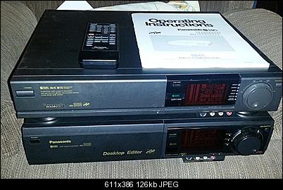

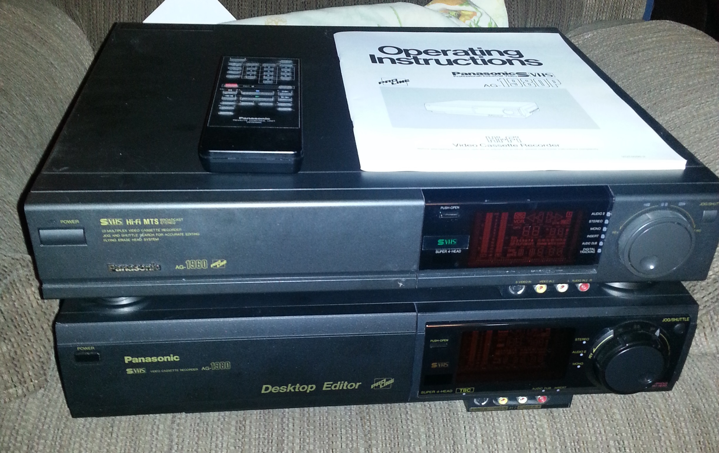

    You said get better VCRs, and I took your advice. Scored a 1960 AND a 1980 for an unbelievable price. I haven't thoroughly tested them, but he was the original owner and has kept the 1980 unplugged for much of it's life, because he felt the 1960 was a better built unit. It even came with a remote the original manual in mint condition!

    The two acquired VCR's ought to get you somewhere. Here's hoping you have better luck with them.

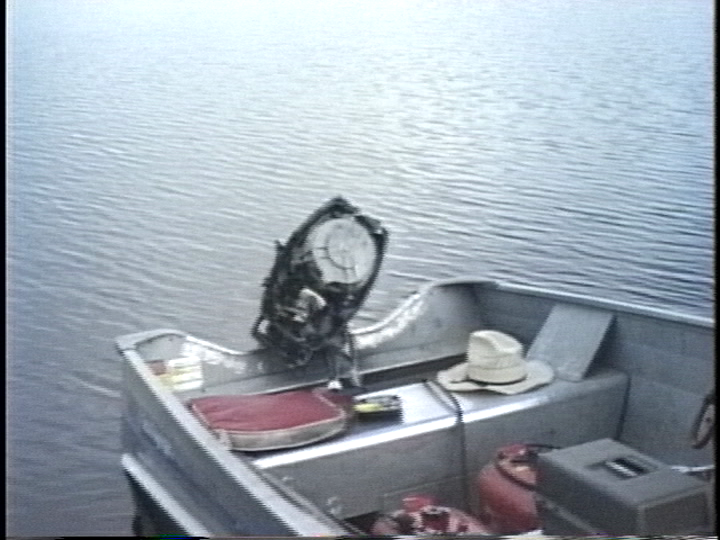

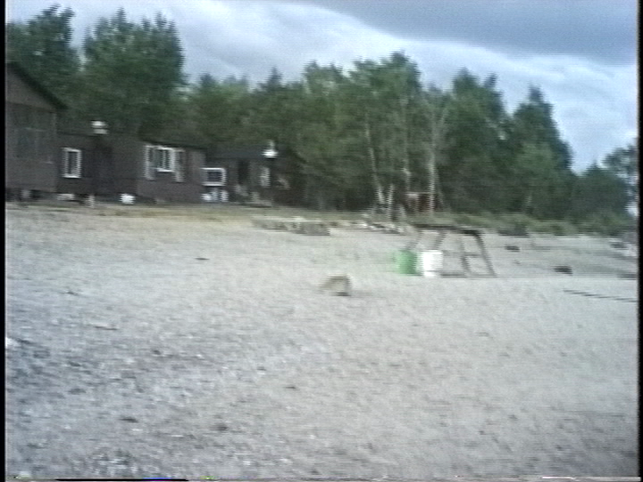

    When I converted my old home videos from old Video8 to MiniDV, and thus a file on my hard drive, I used a Sony TRV-460. When I had an old VHS tape, I simply used the line in function of the TRV-460, and connected the Firewire to my Macbook. The quality was better than any capture card.
    Here's a screen grab from 1988, about the same period as yours, and there's no noise.
    It was hard to get a decent still from the video since my brother (at 12 years old) didn't hold the camera still. Now he's pushing 40, and with a brand new AVCHD camera - still can't hold it still.

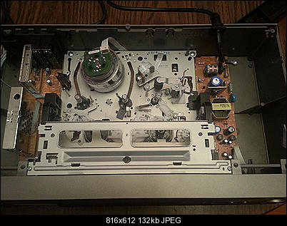

    There ya have it. Not much to the v101. At first I was worried the box was empty, because it was so very light. The playback is actually pretty good compared to my other units (disclaimer that the AGs need servicing). I'm working on some tests, but don't want to ruin an important tape. I also need to spend some time with the instructions. Seems like you can't have the "Video Stabilizer" AND the TBC on at the same time.
    Looks like all of the settings are in the OSD menu rather than with hardware switches. Seemed like the remote wasn't working, but the VCR is actually set to "B" codes some how. Once I found how to make that adjustment with the remote, it worked as well.
    Just ordered a set of Monster THX 1000 S video cables (new old stock, not ebay fakes), got a good deal.
    Had a line on an S9600 sold locally for a ridiculously low price. The guy jerked me around for several hours. I couldn't get a phone number or an address like I was dealing with a paranoid woman. He said he wanted to meet a grocery store (wtf right?). Then when I'm actually on my way out there, I get an email from him claiming it was "No longer available"! He claims he thought I was interested in something else he was selling. He finally gave me a phone number with that email, so I called and asked him what happened to it. He said he left it behind when he moved, which seems suspicious since he had just posted a picture of it. Huge waste of time, very disappointing evening, should have known it was too good to be true.

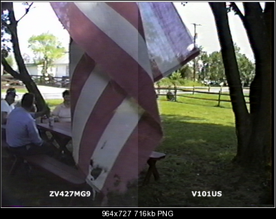

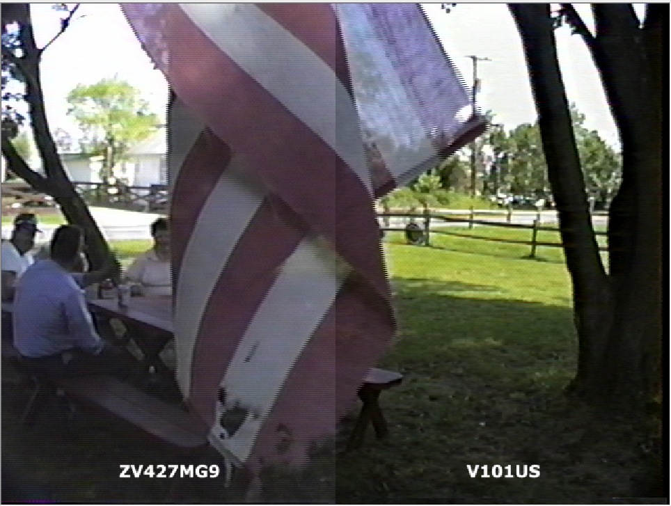

    Took a long time to put together, but I finally got a SBS video comparison between the Magnavox and the JVC.
    Both of the clips were captured with the new(ish) capture machine. New 9600 AIW in a good, grounded case, with a new Seasonic PSU.
    There is still significant noise on the MGNVX, and to a lesser extent the JVC. They are about as far away from noisy sources as I can get them at the moment. I have Monster S video cables on the way that may mitigate this. Although, if the noise was because of the cable, it seems like it should be the same intensity on both captures, while it is actually very diminished on the JVC. Both units are plugged into the same UPS, nothing else on the circuit except a handful of computers. With the same cables & the same power source, I'm not certain what else the source of the noise could be, besides the tape.
    Still no external TBC, it's on the list.
    Mostly, I notice a lot of flashing and blown highlights on the MG; better color rendering and less noise on the JVC.

    I find two separate captures trimmed to the same starting frame (or one file with the captures Interleaved) easier to compare since you can see the same portions of each image.
    Kind of annoying that the better VCR has more head switching noise.
    Oct 2013
    You know, the Panasonic was the same way. I thought that was actually a problem at first because the Magnavox has so little distortion at the bottom.
    If you have suggestions on how you'd like to see a comparison presented or more tests carried out, I have the original captures and of course the tapes and VCRs still.

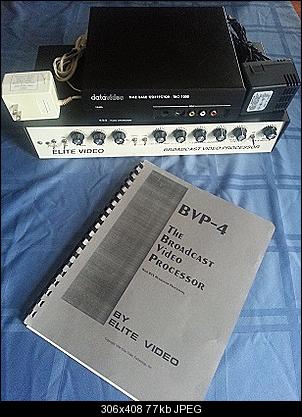

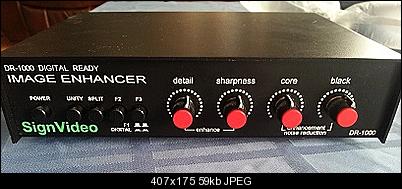

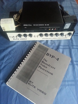

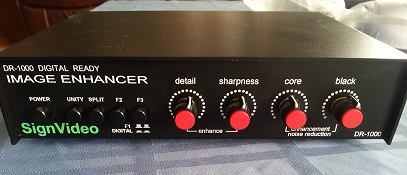

    Looks like Xmas came Early! Let's Talk Workflows....
    Also, does anyone have experience with using non-stock adapters with the DR-1000? I ask because I know the BVP4 is particular about it. The DR-1000 I got didn't come with the original adapter.

    Last edited by Dark-knight; 27th Nov 2013 at 14:50. Reason: Reduced size of attached pics.
