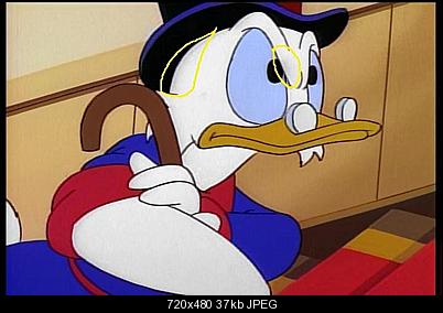

    Not really. It's the result of previously poor processing and low-bitrate encoding. This kind of noise should be treated early-on in lossless yuv media before other filtering. You can try a few fixes such as derainbow filters like BiFrost.avsi, or chroma movers like ChromaShift.dll . The original oversaturation and juiced-up contrast didn't help, either. Another problem: the effects are intermittent, look different in other shots, and don't appear in some at all. It would involve playing with chroma cleaners forever and splitting the video into separate shots to suit each filter for each problem. In the shot posted, you didn't note the red bleed on the shirt sleeve and the magenta smear on the white elbow.

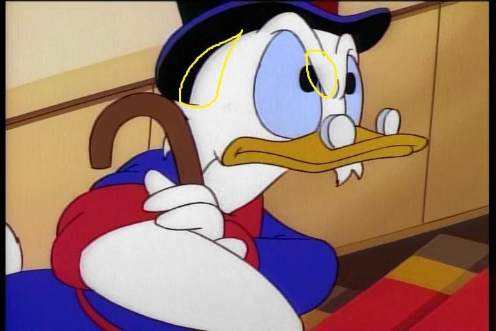

  16. This struck me as an interesting problem so I spent some time on it. I came up with something that almost works for that one image. I don't know how well it will work with the entire video. My first idea was to convert the bright areas of the picture to greyscale. Unfortunately, when setting the threshold low enough to remove the color bleeding in the white areas it ended up removing colors in other bright parts of the picture (the blue eyes, the tan background). So I decided to build a mask that combined the brightness with the saturation (inverted) of the image. So only bright areas that are already nearly white are converted to greyscale. Here's what I came up with:

    Overlay(last, GreyScale(last), 0, 0, mask)

    Unfortunately, it also removed the slight cyan tinge on the front side of the glasses. It will do the same on any other near white areas. And it only removes the tinge on bright areas. If Donald was grey the tinge would not be removed.
    A similar approach would be to remove the color on all parts of the image that are already nearly grey. You could do that with this script by only using satmask. That would get rid of the tinge and still have the problem where the glasses turn white. But it would also work on grey and black areas.
