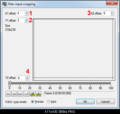

  2. It is the same as VirtualDub except you have to use negative values for the right and bottom. What's so hard about that?
    Crop(4,2,-6,-8)
