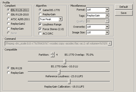

  8. No problem, ConverterCrazy. If you're new to foobar2000, the attached files may help.
    Create a folder called "encoders" inside the foobar2000 folder if there's not one there already, wherever it's installed.
    ie C:\Program Files\foobar2000\encoders
    Unzip the attached "encoders.zip" file and copy the contents to the encoders folder.
    foobar2000 keeps it's third party DSPs in the user's application data folder, along with all it's configuration files. I can only tell you where that is for XP.
    C:\Documents and Settings\User name\Application Data\foobar2000
    If you want to use the R128 compressor DSP, unzip "foo_r128norm.zip" and put the unzipped "foo_r128norm" folder in:
    Application Data\foobar2000\user-components
    (restart foobar2000 if need be)

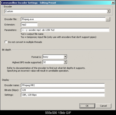

    Add files to a play-list, highlight them all, right click, select Replaygain, and hopefully those menu options will be self explanatory. You need to run a ReplayGain scan if you want to adjust the files or save the ReplayGain info to tags for use when re-encoding. You don't need to if you're using the R128 compressor DSP when converting.
    If you right click and select "convert", then select "..." at the bottom of the list (if there is one) that'll take you to the encoder configuration. That's where you create conversion presets and DSPs are added under the "Processing" link. Up top of the "Processing" page is a button for configuring how any ReplayGain info saved to files will be used when converting.

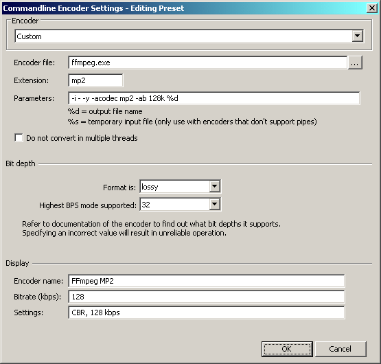

    Configuring an encoder setup shouldn't be too hard (there's encoder set-ups in a dropdown list), although there's no pre-configured set-up for ffmpeg (and no AC3 or MP2), so as I use ffmpeg for both, here's an example for you.
    A custom encoder preset for converting to MP2:
Name:	foobar2000 ffmpeg.gif

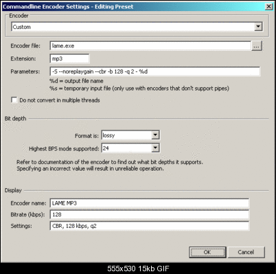

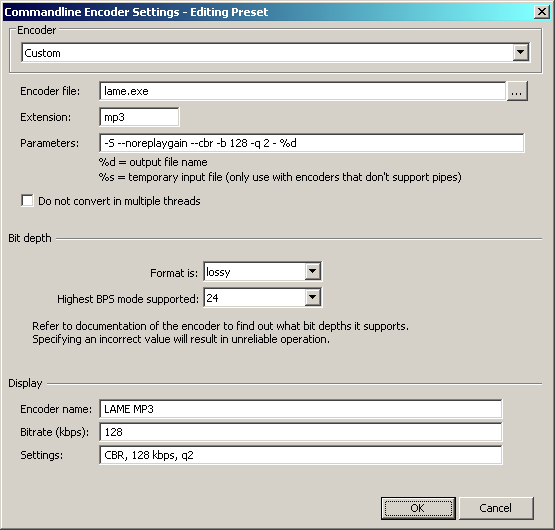

    There's only variable bitrate Lame MP3 presets. If you need constant bitrate MP3, select "MP3 Lame" from the list at the top, then change it to "Custom". Foobar2000 will fill in what's required for a VBR MP3 encode, and from there you can change it to this (of course you can choose your own bitrate):

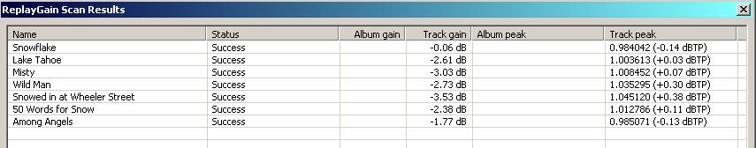

    Some tracks ripped from CD to Flac and scanned (true peak):

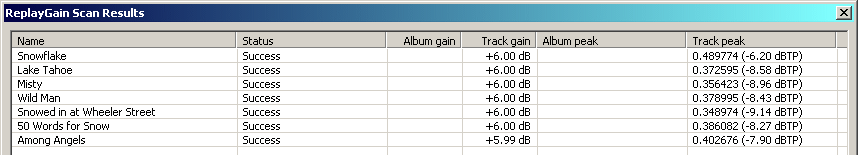

    Converted to Flac again using the ReplayGain info, minus 6dB for a target volume of 83dB, and scanned again:

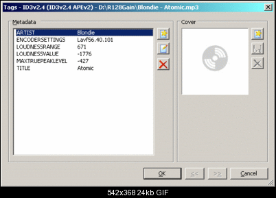

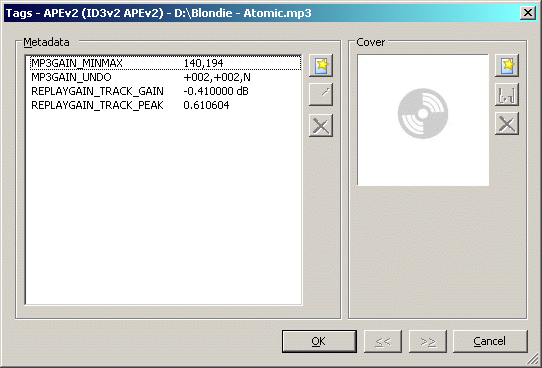

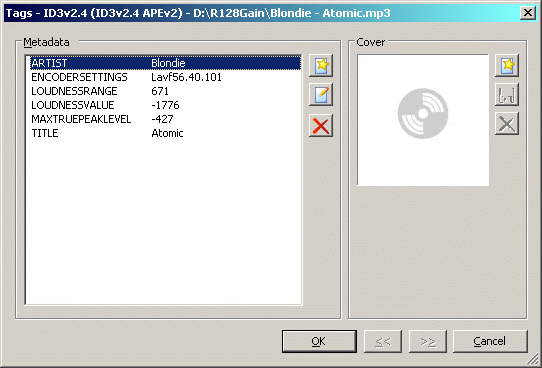

    Speaking of expressing things in practical units:
    LoudnessValue = -1776. Not having needed to use those tags I've never tried to work out how to convert them into something meaningful. It might as well say LoudnessValue = Pink Elephant. If I load that file into foobar2000 it'll display those values in ReplayGain-speak. It turns out LoudnessValue -1776 equals TrackGain -0.41dB. That means something to me.
    As does this. I've even converted percent to dB enough times to know the peak is around 4.5dB below clipping without reaching for a calculator.

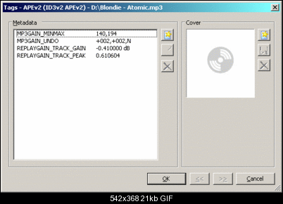

    Edit.... Ahhhh I think the penny dropped. I know -1776 is pretty close to ReplayGain's 89dB. Using that as a reference, because I know ReplayGain 89dB = -18LUFS, I assume -1776 refers to -17.76 LUFS and the peak is -4.27dBFS.
    I guess I need to backpeddle a little on that one, but seriously, wtf aren't the tags written that way in the first place?
    I've been using ReplayGain since the day I bought my first MP3 player. Long before the loudness debate really heated up, and long before EBU R128.
    Because I think in ReplayGain terms I don't tend to look at ReplayGain as confusing the issue, but more like this. No reason why everybody can't get along.

    The other day when I posted a screenshot of the R128Gain GUI it showed -18.8 LUFS as the ReplayGain target volume and I wrote that ReplayGain's 89dB must equal R128's -18.8 LUFS, but when I ran the GUI today and reset it, it showed -18 LUFS, so I guess I must have inadvertently changed the ReplayGain setting and therefore that was incorrect. ReplayGain's 89dB target volume = -18 LUFS.
    I'll edit my previous post to fix that and replaced the screenshot with a new one so as not to confuse any future readers of this thread.

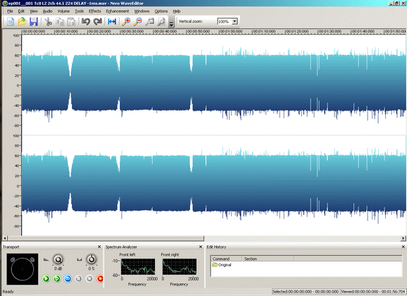

    Attaching a clip of original video file. If it might help.
    Thanks.
  21. Originally Posted by ConverterCrazy View Post
    I can only wish you luck.

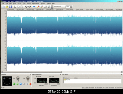

    The problem isn't that it's loud, although it is.
    The problem isn't that the peaks are too loud, because even using true peak scanning they're still a couple of dB below maximum.
    The problem isn't that it needs to be compressed. I think it sounds loud because it's already heavily compressed.
    The main problem with that sample is it's already been clipped somewhere along the way, and that's why it sounds distorted.
    I made a quick attempt to do something to improve it without success, but to be honest that audio would be in the "not worth it" category for me so trying to fix something like that would be a fair way out of my comfort zone.
    Audacity has a clip detection function that didn't seem to be able to detect the clipping, and it's clipping repair DSP had no effect. Maybe that's just an indication I don't know what I'm doing though.
    The old version of Nero Wave Editor I have also has a clipping repair function, but it wasn't doing much.
    I think part of the problem.... and admittedly I'm doing some guessing here..... is the waveform seems kind of "off centre" and I don't seem to be able to do anything about it, and that's possibly why any clipping detection and repair isn't working. Someone more clever than me might know.
    If you look at the wave form, visually the "0" line looks off-centre.

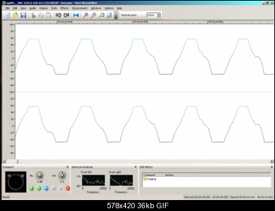

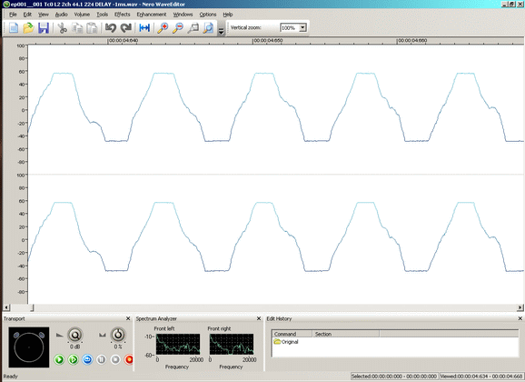

    And if you drill down there's plenty of flattened peaks to be found.
    As I said, someone more clever than myself might be able to restore it to some extent, but the attached sample is the original audio simply normalised to ReplayGain's 89dB. It's so compressed the peaks are about 13dB below maximum but it still sounds like crap.... just at a lower volume than before.

    I can see the flat peaks and 0 offset too in the screenshots. But can't make out the software/tool you used to see them.
    The FLAC file you uploaded sounds a bit better than any version of mine.
