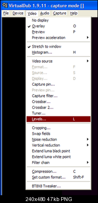

    ES10 and ES15 look identical. To answer the qustion of the thread;s title: Does it look right? Well...it looks much better than the original, but it doesn't look "right". Levels are within the valid RGB16-235 range (for PC color, but not for TV display), and color is oversaturated.To a large extent, luma and chroma are affected by each other, but you can have a "dark" luma with oversaturated color, which is what you have in both captures. Each can be adjusted independently in YUV. The Avisynth capture histogram doesn't pinpoint saturation issues in themselves; that's something you have to judge by eye most of the time. You can tell if colors are oversaturated when you have what appears to be a "correct" luma range, but colors begin to bloom and look plastic.
    The filter control that I set in VirtualDub capture is this one:

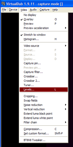

    The dialog that appears is based on my ATI 9600XT capture card:
    There are other ways to do this, far more complex, but the controls shown are all you would need. Denoisers are too slow for capture, not very good anyway, and usually give you a colorspace conversation you don't want. Trying to correct "Hue" during VHS capture is an exercise in futility unless you have something really haywire coming in--and with VHS it will change with every camera shot anyway. And don't use the sharpener with VHS: all you'll sharpen is noise.
