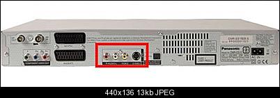

  13. The s-video or composite input on the rear.
    Or the SCART input if that's all you have.

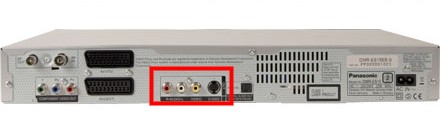

  14. Originally Posted by jagabo View Post
    It doesn't have composite in at the back, only out.
    Please bear in mind that i have a european unit. This means i have 2 scart connectors on the back. Should i try to use those?Or is that a multi-use port, and am i able to use it as in and out?
  15. Ah. Yes, use the SCART input on the rear.

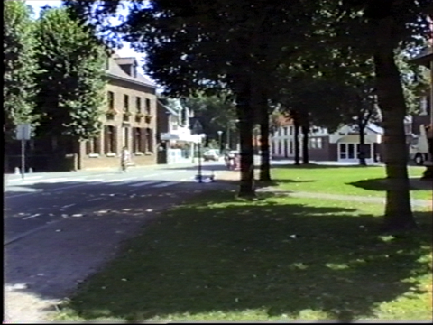

    Excellent, and a vast improvement over earlier captures. While you might not yet be accustomed to analyzing video glitches, I think you can easily see a vast difference. The image below is frame 307 from AVI2. It's a bit fuzzy because it's a capture of an interlaced frame with camera movement (it will not be so fuzzy played on TV). This is the sort of scene that is difficult to capture well because of the contrast range. However, your settings have preserved useable dark and bright detail quite effectively.

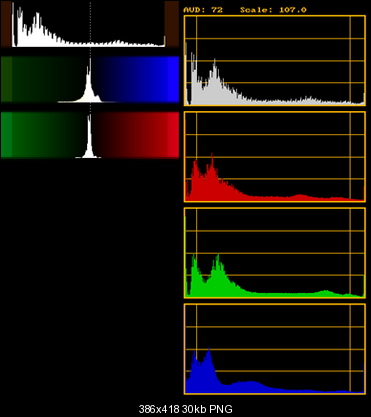

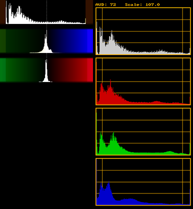

    You might have noticed that the "brightness" control usually controls black levels, while "contrast" usually affects highlights. In practice they interact somewhat, so you've likely found that a bit of twiddling is involved to achieve a balance between the two. Well done. The camera's auto gain control (AGC) can be problematic at times, but as long as you can maintain a manageable range of levels it will be the best compromise. I think you did quite well with this difficult scene. Some software tweaks later can help with even more improvements where required.
    To demonstrate more graphically what is happening, two types of histogram are shown below. The image to the left is an Avisynth YUV levels histogram that shows how video data is stored in YUV. On the right is a VirtualDub RGB histogram showing how the same video data is interpreted and displayed in RGB. Both histograms have common attributes: the darkest colors are at the left, brightest at the right. Each has a border marking at the right and left edges that indicate areas to be avoided for the usual video levels and chroma.
Name:	AVI2 frame 307 YUV and RGB.png
    In the YUV histogram on the right, the top white bar shows luma ("brightness") levels. The shaded areas on the left and right are the darkest and brightest luma values respectively: you would want avoid those two shaded extremes most of the time. It's not always possible to do that exactly with a video that's in constant motion between dark and bright shots, but this shot shows that you've used settings that "protect" the darkest and brightest areas from being crushed or clipped. In both histograms you'll usually see a "peak" of some kind on the far left: that peak would indicate the darkest areas such as black borders and objects that are too dark to have any detail anyway. In a YUV histogram like this one, the blue and red channels don't really say that much because in this particular histogram they aren't all that accurate anyway. Avisynth has other histograms that get into more detail with color.
    The RGB histogram on the right shows how the dark and bright extremes are slightly "expanded" when converting YUV to RGB. There is a small amount of overshoot into the left area and some chroma overshoot into the right-hand edge. But in this case you're fairly safe; and black borders on the left will almost always creep into the left-hand side. Most display devices allow for a little leeway on either side; what you want to avoid is luma or colors smashing against the left and right walls and climbing up the sides. The two side markings in the RGB histogram are set to indicate RGB 16 (on the left) and RGB 235 (on the right).
