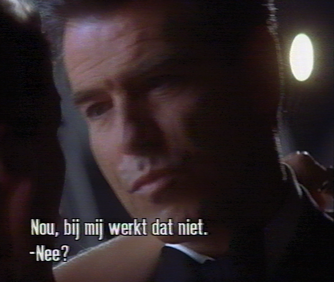

  1. I have tried several ways to digitize and restore VHS tapes.
    At this moment i am trying to use my Pinnalce PCTV Studio Pro as capture device. While most captures trough my usb capture device were distorted they look almost perfect trough the pctv.
    However i noticed a lot of "noise/lines" trough the image. I already turned on the noise reduction in virtualdub capture mode which seems to help. However i need to know if what i am having now is acceptable/normal or if should change some settings/hardware.
    sample: https://forum.videohelp.com/images/imgfiles/El8KYFU.png
    What is your opinion about the quality of the source?

    How do you define right ?
    VHS has noise. Without filtering you will get noise. Noise reducion can soften the image so indeed your picture is not 'right'.
    I would not filter at the capture point unless you have hardware picture enhancement available - we do not know your equipment. Do it in sofware at the capture point as you have done could have damaged it and lessened the chances to restore with post-production filtering in avisynth etc.
  3. If you want to offer a sample, make it a video sample, not a picture. 10 seconds with steady movement is plenty.
    No idea what that means. Maybe that you were capping at 720x576 and people looked too tall and slender (if PAL). Perfectly normal.
    If by that you mean interlacing (look it up), then also normal. Like DB83 I wouldn't denoise while capping, but later on.
    What VCR was used?
  5. @manono
    Distorted in the sense that i was thinking about buying a TBC. (like this: http://2.bp.blogspot.com/-LlfNjq-RXVg/T4L7FFFPbbI/AAAAAAAAAGM/k_N_L6YXq04/s1600/before.jpg)
    It's not the interlacing, the picture looked quite noisy on my "capture" pc, however it looks quite a bit better on my pc here.
    @DB83 & @lordsmurf
    The hardware i'm currently using:
    - Consumer grade VCR: JVC HR-S6700EU
    - "hq" shielded cables (not the cheapest one's, not the most expensive)
    - Pinnacle PCTV studio pro as capture device (bt8x8 chip).

    If you just want us to go by the jpg, It needs more work. Without a video sample, there's little more one could say. But it doesn't look so great with all the chroma noise and dot crawl on the captions.
    The image you just posted isn't a picture of a tbc. If you mean that buying what people typically mean by a frame-level tbc, it won't fix the problem you pictured.

    A single still does NOT, as manono states, give ANY indication for the need of a tbc. There is no distortion(other than AR) in that pic IMHO just noise.
    Post a sample video representative of any issues you really think are present else we will get nowhere.
  8. I agree, I will post a video sample tomorrow.
    What i meant with TBC is that if i capture trough a usb capture device, i get a very distorted picture like the one in the picture.
    Recording trough the pctv, the picture isn't distorted.
    I will record a video tomorrow and it will be much clearer. Sorry for the picture.

  11. Video Restorer lordsmurf's Avatar
    The VCR is crappy, and it has timebase errors (no TBC).
    The capture is not very good, no.
