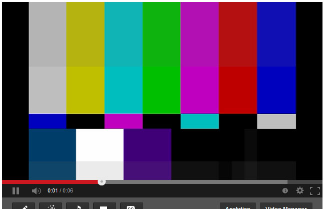

  16. @2Bdecided, I'm seeing a difference in material encoded 16-235 and 0-255 as played back by YouTube, identical encoding in TVMW5. The image below is composited screengrabs. Honest question, is there something I'm not taking into account?
  17. Be specific in how your test is configured. Did you mean YUV values or RGB values ? Encoded and uploaded as YUV or RGB ?

    For the OP - 99.999999999% of the time, it's a configuration issue. On a properly setup TV and Computer/GFX card/Monitor setup they should look close to the same on a TV or Monitor . I'm guessing it's your computer setup , either your GFX card settings or monitor

    @2Bdecided, I'm seeing a difference in material encoded 16-235 and 0-255 as played back by YouTube...
    If the video has different levels you will see a difference. Using the wrong levels will create a visible difference. It doesn't make it right.
    I encoded a suitable testcard using x264 and uploaded it to YouTube...
    http://youtu.be/r9pLqea8iDQ
    As you can see (unless YouTube looks different on your PC to mine - always possible!) 16 comes out as black and 235 comes out as white*. The files (DV-AVI original and x264 encoded mp4) have whiter-than-whites and blacker-than-blacks (as labelled: 255,251,239 / 12,4,0), but the YouTube player clips them all to 100% white and 100% black, as expected.
