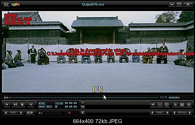

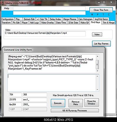

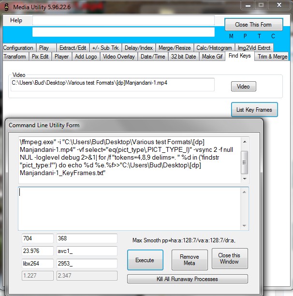

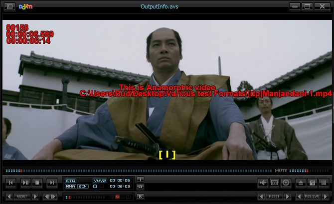

    FWIW.. I am working on this feature but have not perfected it yet for some of the reasons listed here. I used the script shown to create a list for a variable bit rate MP4:
    ffmpeg.exe" -i "C:\Users\Bud\Desktop\Various test Formats\[dp]Manjandani-1.mp4" -vf select="eq(pict_type\,PICT_TYPE_I)" -vsync 2 -f null NUL -loglevel debug 2>&1| for /f "tokens=4,8,9 delims=. " %d in ('findstr "pict_type:I"') do echo %d %e.%f>>"C:\Users\Bud\Desktop\[dp]Manjandani-1_KeyFrames.txt"
Name:	ScreenHunter_212 Mar. 05 23.08.jpg

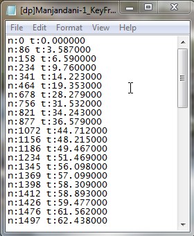

    This results in a list as shown below:
    Name:  ScreenHunter_213 Mar. 05 23.08.jpg

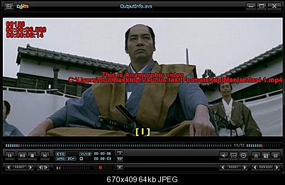

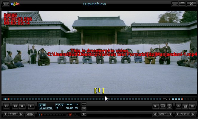

    The problem remaining is that the list is off by a certain amount while the actual displayed type is correct in the viewer (Potplayer) using an avisynth script and remains off about the same amount:
    FFmpegSource2("C:\Users\Bud\Desktop\Various test Formats\[dp]Manjandani-1.mp4", atrack=-1).Crop(0,0,-0,-0)
    ScriptClip(Last, """Subtitle("[ "+Chr(FFPICT_TYPE)+" ]", size=(Height*56.0/720), align=2)""", after_frame=true)
    LanczosResize(864,368)
    Subtitle("C:\Users\Bud\Desktop\Various test Formats\[dp]Manjandani-1.mp4", x=864, y=204, font="Arial", size=24, text_color=$ff0000, align=3)
    Subtitle("This is Anamorphic video", font="Arial", size=24, text_color=$ff0000, align=5)
    ShowFrameNumber(scroll=true, x=10, y=27, font="Arial", size=24, text_color=$ff0000)
    ShowTime(x=72, y=44, font="Arial", size=24, text_color=$ff0000)
    ShowSMPTE(fps=23.976, x=68, y=61, font="Arial", size=24, text_color=$ff0000)

    Seems to be a real need, at least for me, so still working on it.
  29. 2 cents of thoughts from me:
    1. If you want to use avisynth on the whole clip, you should also use avisynth to extract the I-frame positions. (see: https://forum.doom9.org/showthread.php?p=1607578#post1607578)
    2. ShowTime will only show the correct time if your video has no a/v delay and is cfr.
    3. Instead of using ScriptClip it would be easier to use FFInfo.
