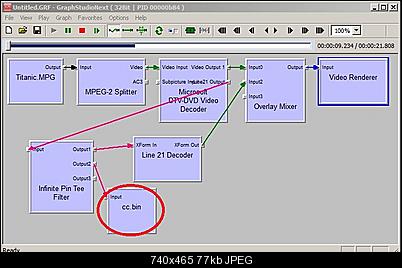

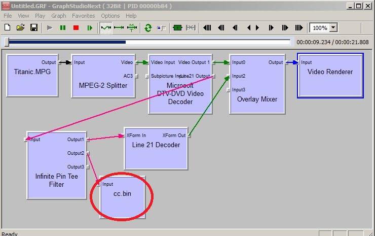

    The mpeg clip lists CC'c in MediaInfo (eia-608) and are seen when the graph is played.
    The dump bin file contains something(?) but CCExtractor doesn't see any information and outputs an empty .srt file.
    Any ideas?

    Aren't you trying to send that to a file sink?
    The dump filter collects and saves the output to the .bin file.
