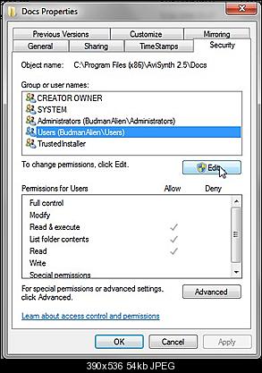

    Try going to the folder in question and right clicking and choose properties. Click the security tab and highlight your user(yourname) and click edit.
Name:	ScreenHunter_35 Oct. 13 23.24.jpg

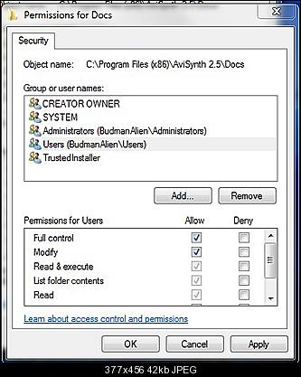

    Highlight your name again or add it if it isn't there and click full control. It always works for me in Windows 7:
Name:	ScreenHunter_35 Oct. 13 23.25.jpg
    I know you are administrator but Windows 7 seems to mean THE administrator Administrator not User administrator. You should also be able to facilitate the attributes as mentioned and the files inside the folder should now be accessible also
    [Attachment 20528 - Click to enlarge]
    [Attachment 20529 - Click to enlarge]
    Did that too. ^^;;There is only one user to edit - and that is self. And under the network, too, it's all selected to be changeable. In fact, to test it myself, I unchecked all the things for both local and self-user. I don't know of any other way to get to THE Administration outside of being the admin self to do it. There are no other users on the computer. Outside the network.

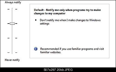

    Good call Jagabo (as always)! Might also check the UAC settings (Click start, type UAC, and select Change User Access Control Settings)
    Keep mine set at default so it always gives me a hassle but it's easy to fix. Compare your 2 computers also.
