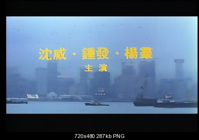

    Hi Friends,
    I have a clip here, and the credits look strange. Is this what would be characterized as "dot crawl"? Would checkmate fix this?
    http://files.videohelp.com/u/183506/beauty.demuxed.m2v
    Thanks!
  2. Formerly 'vaporeon800' Brad's Avatar
    Apr 2001
    Vancouver, Canada
    Yes it's dot crawl. Checkmate should mitigate it, but as with anything, be careful of unwanted side effects.

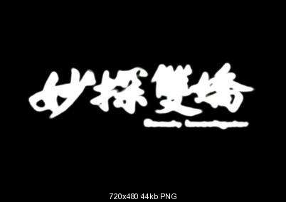

    But the U channel is half the size (each dimension) of the full picture so we need to upscale it. We also want to massage it so that the characters are white and the rest of the image black
    mask=UtoY().Invert().ColorYUV(off_y=-128).ColorYUV(gain_y=512).BilinearResize(width, height)

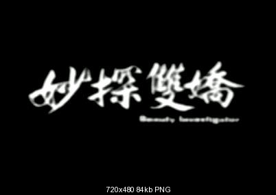

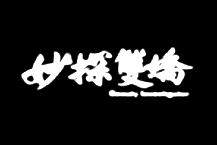

    But the dot crawl artifacts extend outside the characters. So we need to blur and expand the mask to cover an area slightly larger than the characters:
    mask=mask.Blur(1.0).ColorYUV(gain_y=50)

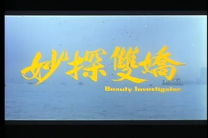

    Now we have a suitable alpha mask. The parts of the mask that are black will show the original image, the parts where the mask is white will show the filtered image, and the greys in between will be a blend of the original and filtered images.
    Let's make a highly filtered image that eliminates the dot crawl artifacts.
    CheckMate(thr=10, max=20, tthr2=20) # removes lots of the dot crawl
    TTempSmooth(maxr=6, strength=6, lthresh=200, cthresh=100, lmdiff=10, cmdiff=15) # removes more of the dot crawl
    aWarpSharp(depth=15) # sharpen the result a little
    It's not very visible in this picture but the strong temporal filter causes blurring and ghosting of moving objects. So we want to use our mask so that only the yellow characters and the area immediately around them are filtered:
    Overlay(src, last, 0, 0, mask)
    Notice how the boat behind the right-most character is much clearer than in the highly filtered image.
    The full script:
    Mpeg2Source("D:\Downloads\beauty.demuxed.d2v", Info=3)
    TFM().TDecimate()
    src=last

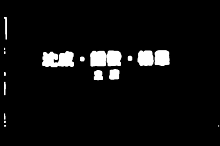

    orig=MPEG2Source("beauty.demuxed.d2v", cpu=0)
    orig
    crop(14,56,-2,-64,true) #be careful mod4 rules for vertical interlaced crop (cropped before ivtc)
    cropped=last
    cropped
    assumetff()
    tfm()
    tdecimate()
    ivtced=last
    cropped
    tcomb(fthreshL=16, othreshL=20)
    checkmate
    tfm
    tdecimate
    santiag(3,3)
    awarpsharp2(depth=4)
    mergechroma(awarpsharp2(depth=10))
    filtered=last
    ivtced
    converttoyv24()
    maskhs(starthue=135, endhue=205, coring=false)
    mt_expand(thy=255).mt_expand(thy=255).mt_expand(thy=255, mode="vertical")
    binomialblur(1)
    mymask=last
    #mymask
    overlay(ivtced, filtered, mask=mymask)
    addborders(14,56,2,64)

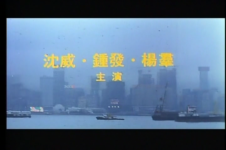

    The original
Name:	1044 original.png
    Filtered , no mask (notice the blurring of details in the background, the boats)
Name:	1044 filtered no mask.png

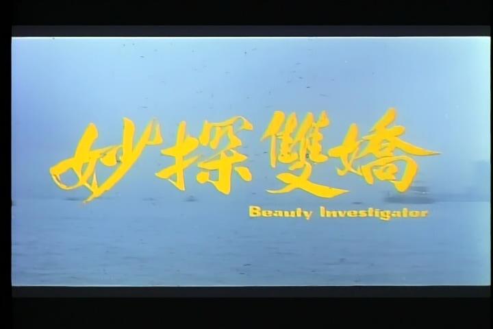

    Mask
    Filtered with mask (notice the missing background and boat details are intact)
Name:	1044 filtered with mask.png
    Edit: I see jagabo posted another solution as I was typing. There are many ways to isolate masks, and the general concept of masks is really the key message that you want to learn about here
    TFM().TDecimate()
    src=last
    filtered=last
    TFM().TDecimate()
    ivtced=last
    filtered.trim(0,2751) ++ ivtced.trim(2752,0)

  24. Here's an example using ReplaceFramesSimple.
    # first make a unfiltered version (except for TFM TDecimate)
    unfiltered = TFM().TDecimate()
    # then make a highly filtered version
    TFM()
    TDecimate()
    Overlay(unfiltered, last, 0, 0, mask)
    # At this point you have two videos: "unfiltered" and the heavily filtered "last"
    # Assuming the sample is the same as the start of the full movie, use
    # only the heavily filter frames from 166 to 1751
    ReplaceFramesSimple(unfiltered, last, Mappings="[166 2751]")
