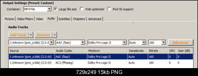

    I'm a complete novice to all this. I have video that I recorded with a very old Sony CamCorder (circa 2000, though it was very good for the time) and I transferred them from the camera to hdd via a program who's name escapes me now. WinDV I think, but it's been a long time.
    The current format on hdd says "video clip" and when I load it into Handbrake it sees it fine. I run the conversion to MP4 and the video looks great but there is no sound. Here are the settings and what HB sees.
    Any tips on how to get sound with the video? I've done conversions of other files, like mkv's, and sound came through fine.
    Thank you.

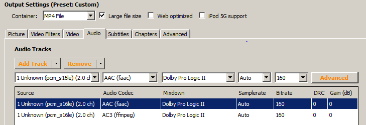

  6. It turns out that vidcoder seems to include audio just fine. What's puzzling to me though is that vidcoder says it uses Handbrake as it's encoding engine, so why would vidcoder work and handbrake not?
    Anyway, the test file seemed to come out just fine so I'm working on a few more to see how it goes. I'll have a better idea in about 5 hours.....
    Thanks!
  7. Vidcoder has worked like a charm on 30+ video clips now. Thank you for the pointer!
