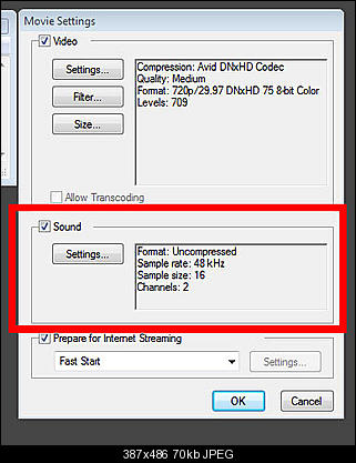

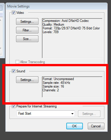

    No audio in final MOV. I have to on the audio channel while encoding ?
    When the movie settings dialogue box pops up you have to tick video and sound. With DNxHD choose 48kHz, 16 bit, 2ch

  18. You don't get this popup when using QTOutput?
  19. Nope.... no at all
    I directly get the compression settings.

    Ignore that part, are you not getting the Movie Settings popup when you run your avs script?

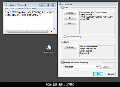

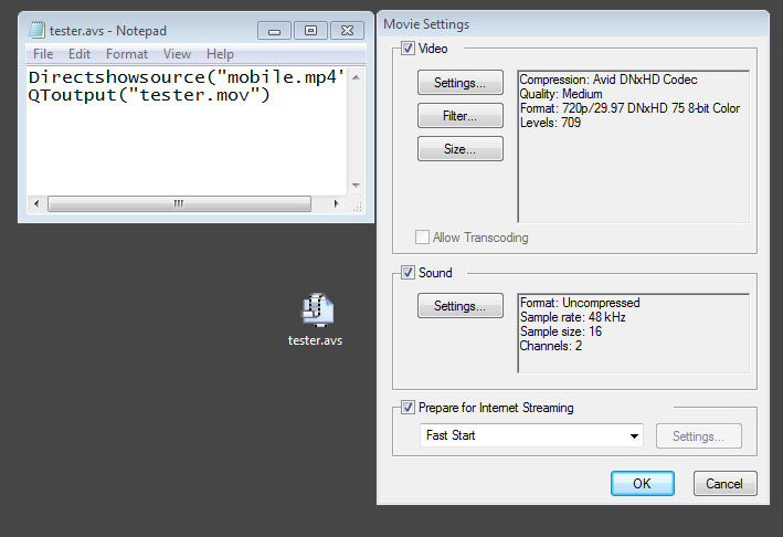

    So how are you setting your video codec to DNxHD? Some screenshots may be helpful at this point.
    Edit: Stop changing your posts so much. I keep answering questions you delete.

  27. In order to get that window above, I think you need quicktime pro

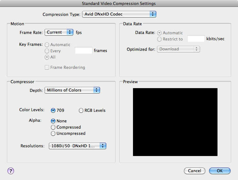

  28. Sorry for editing the posts.
    Settings Values are smillar to the image attached.
  29. Originally Posted by DayDreamer3d View Post
    In order to get to that screen, you should have to go through this one:
    I thought that may be the case, but it turns out it works with a standard installation as well.
    Edit: Waitaminute! Daydreamer, Your screenshot is from a mac. How are you using avisynth?
