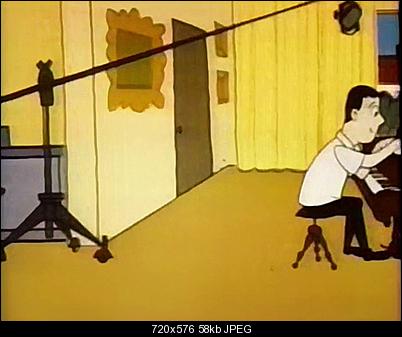

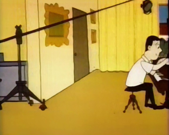

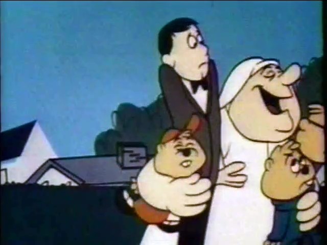

  18. If you want some thing quick and dirty to start with:
    ffVideoSource("E1 Good Neighbor.mp4")
    Stab()
    TTempSmooth(maxr=6, strength=4, lthresh=20, cthresh=25, lmdiff=10, cmdiff=15)
    HqDering()
    Sharpen(0.3, 0.0)
    Santiag()
    MergeChroma(aWarpSharp(depth=10), aWarpSharp(depth=20))
    Overlay(last, ColorYUV(off_y=-8, off_u=9, off_v=-2), 0, 0, GreyScale(last).ColorYUV(cont_y=30))
    Crop(2,2,-6,-2)
    nnedi3_rpow2(2, cshift="Spline36Resize", fwidth=720, fheight=576)

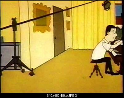

    The strong TTempSmooth stabilizes the brightness/colors in the static parts of the image. It ends up ghosting and losing some low contrast detail in moving areas though -- panning shots, for example. You can play around with the arguments to try to get it working better. Note the curtains in this shot:
    source:
    after TTempSmooth:
    You'll probably want to adjust the mask in the Overlay/ColorYUV line.
    Sample similar to Sanlyn's attached. The full 7 minute clip took about 13 minutes to filter and encode on my i5 2500K.

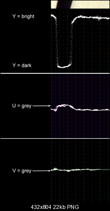

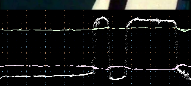

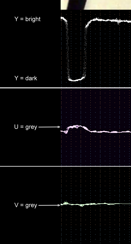

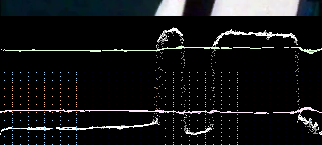

    I think you understand this part but for the benefit of the OP: The use of a mask with overlay is conceptually very simple. Areas where the mask is black only the first image shows through. In areas where the mask is white only the second image shows through. Where the mask is grey you get a weighted (depending the shade of grey) mix of the two.
    Why did I use Overlay here to adjust the colors? If you look at the chroma channels you'll see that in black areas both U and V are very close to the neutral grey. But in the bright white areas U is significatnly low and V is a little high:
    If I simply used ColorYUV(off_u=9, off_v=-2) the brights would be close to pure white but the blacks would be discolored. So I wanted a way to apply the ColorYUV adjustment to the bright parts of the picture but leave the dark parts of the picture unchanged. The solution is to use the luma of the image itself as an alpha mask. The black pixels keep the original colors, the white pixels get the adjusted colors, pixels in between get a mix.
    Note, for purposes of this explanation I wanted sample that had both black and white right next to each other. In the above image the sample was taken from near the bottom of a particular frame. The discoloration of this portion of this frame was a bit more than for the overall video. For the ColorYUV adjustment I used compromise values for the overall clip, not for this particular portion of this particular frame.
    I also just realized that I should have left the V adjustment out of that line.

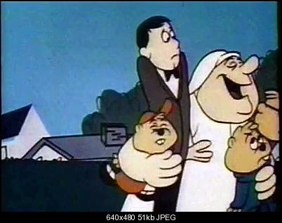

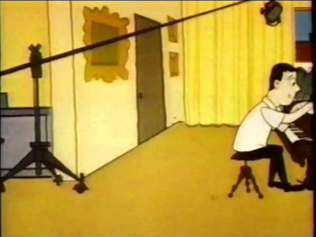

  25. Here's an example with correction customized for that particular crop:
    source:
    after Overlay(last, ColorYUV(off_u=18, off_v=-4), 0, 0, GreyScale(last).ColorYUV(cont_y=30)):
    The full frame after Overlay(last, ColorYUV(off_u=18, off_v=-4), 0, 0, GreyScale(last).ColorYUV(cont_y=30)):
    I assumed the shirt was white and the pants were black in this frame. But I couldn't find anything that I was confident should be pure grey. So I don't know is how accurate the middle greys are after this adjustment. That's where adjusting the mask may help.

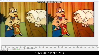

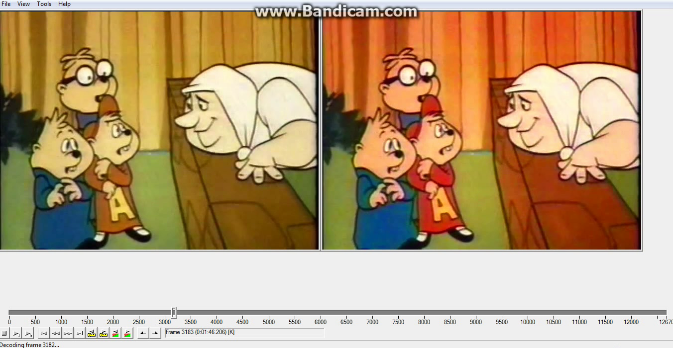

  29. This was the best I could do with Virtualdub in about 5 minutes. I thought it needed more red. Now it looks TOO red. Click image for larger version
  30. Banned
    New York, US
    Nope. The picture on the left needs more blue. Use a pixel value sampler to analyze color problems. The first clue in the pic on the left bis the white in the cloth and the eyes. They're too yellow. You balance yellow (which is red + green) by adding its complementary color, which is Blue.
    There's a free pixel sampler that sits on your desktop and reads pixel values anywhere: Csamp http://www.netreach.net/~gavin/gavsfreeware/csamp.htm
