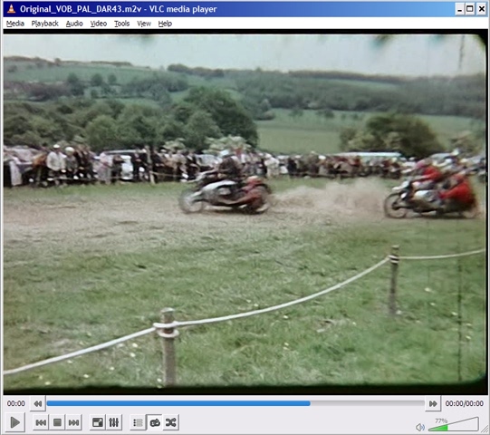

    And here it is in VLC (screen capture) with the player resized for the video. If you don't want side bars on a 16x9 display, configure your player so it won't display for a 16x9 screen. Strikes me as a pain in the neck to do that, though.
    [Attachment 20550 - Click to enlarge]
