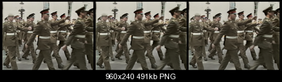

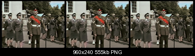

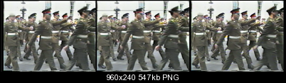

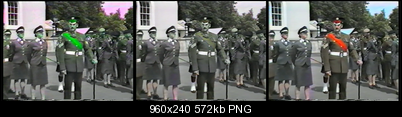

    Working with Clip1. Almost there, using a similar but slightly shorter script. Along the way, I couldn't resist repairing some of the bad frames in Clip1. There are many tricks for this sort of thing. Some work, some don't. Here a few that did.
    Left-click on the images to view them enlarged, and to switch back and forth between "before" and "after".

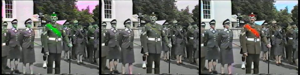

    Clip 1, frames 186-187-188 (these are deinterlaced frame numbers). The original frame 187 (below, middle frame) has a gray horizontal "rip", and something odd: The men appear to be marching backward for one frame. A frame interpolation plugin was used to create a new frame 187 from the previous and following frame, both of which happen to be useable frames. This doesn't work well if the damage exists over several frames. But it worked here. It's one of jagabo's contributions. Original frames 186-187-188:
Name:	frames 186-187-188 original.png
    Fixed:
Name:	frames 186-187-188 after.png

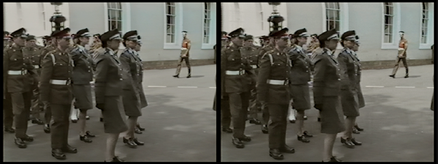

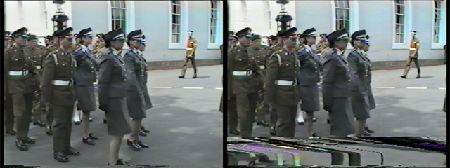

    Clip 1, frames 519-520. The original frame 520 on the right-hand side has a bad flag or "tear" across the entire lower portion. Unfortunately there is no following frame from which to create a new one. So I borrowed the same area from the previous frame 519 and overlaid it onto frame 520. There wasn't much movement, so this worked fairly well.
Name:	frames 519-520 original.png
Name:	frames 519-520 after.png

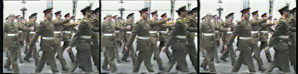

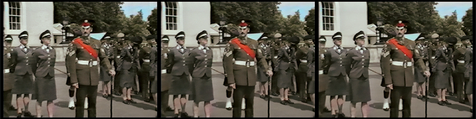

    Clip 1, frames 521-522-523. Thanks to damage in the previous frame that made the tape "bounce", frames 521-522 are a mess, and mostly monochrome. A routine was used to copy the chroma channels from frame 523 into frames 521 and 522. The camera was zooming in, so it's not a perfect fit. But it's pretty close (again, thanks to jagabo).
Name:	frames 521-522-523 original.png
Name:	frames 521-522-523 after.png
