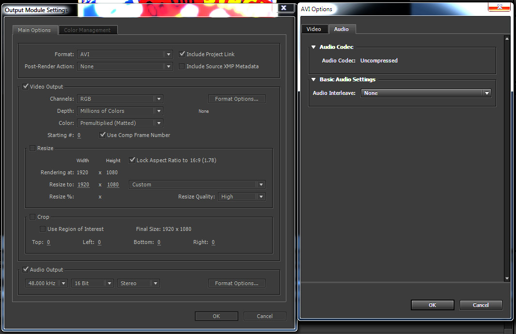

    I've taken a screen grab of the video and audio options selected. Let me know if I missed something. If what you're telling me is that the audio bit rate of my mp3 file is too high, I'll try pushing that down first.

    Shouldn't audio be interleaved? What does "uncompressed" in that audio dialog mean? Does it mean PCM?
    Will your encoder accept RGB32 input? AVCHD encodes as YV12.
    Does "Include project link" enter video header info that throws off your encoder?
    My old AE CS3 allows me to be more precise with most of those options.

  13. Originally Posted by sanlyn View Post
    I don't know. Would that matter at all for an AVCHD disc?
    I don't know. These are out of the box settings for AE CS6.
    I don't know, and I'm not sure which encoder you are referring to. I am trying to get a file out of AE CS6 that will work in multiAVCHD. The consensus seems to be that an uncompressed .avi will work with no problems, but I'm having them. The screenshot shows what audio and video options I have for uncompressed .avi output.

    So what you're saying is that those shots are the settings you used to get an audio output of 96/32. Not going to happen, unless AE was totally buggy. I've got 3 different earlier versions of AE and there's nothing wrong with it's output: it gives you what you set it to.
    ...I just did a test in AE CS3 using a 96/24 file (that doesn't work in most players, editors or encoders). Dropped it into the timeline, set up a render Q, checked output to incl. Audio set audio to 44/16. Ran it...Boom!->File with Audio 44/16. Just like it should.
    You must be doing SOMETHING ELSE. Or a bunch of something elses...

  26. It looks like TX264 will get it done. Sanlyn, thanks for your time and effort!
