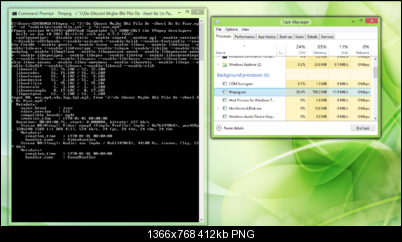

  1. Hi all. I apologize if this has been addressed before but I couldn't find anything searching Google or these forums so I hope I can get some help here. Whenever I try to convert video with -subtitles option, it takes more than 3 minutes for initialization to start the conversation with 800mb ram and 30% of my core i3 processor to render a 19mb sized video.
    ffmpeg -i "J:\Do Ghoont Mujhe Bhi Pila De -Jheel Ke Us Paar.mp4" -vf "subtitles=subtitle.srt" -y "J:\out.mp4"

    The sceenshot:
    If I use ffMBC instead of ffMPEG, everything is fine and no waiting time.
    Any idea what's going on? I have no idea how to fix it. Thanks all.
