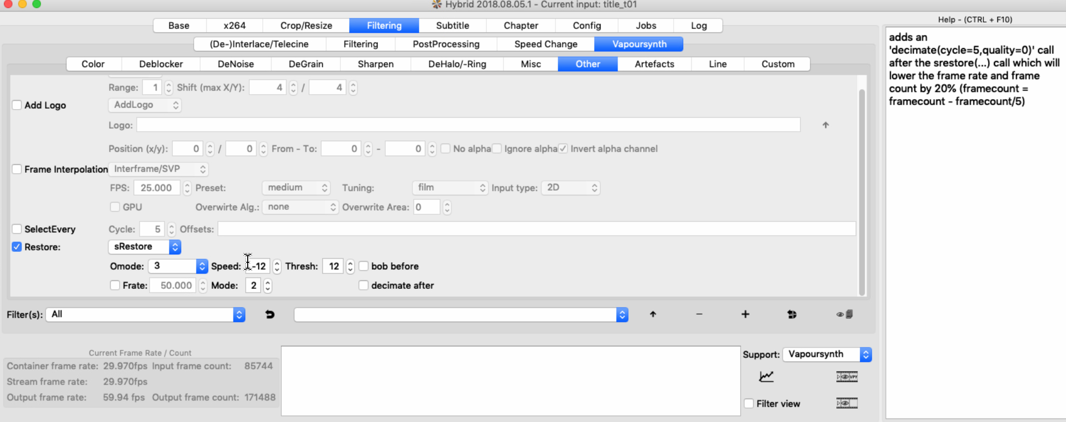

    Wht settings on srestore should i do?
  6. I used the default SRestore settings (the AviSynth version):
    frate = not set (defaults to 25 fps in this case)
    omode = 6
    speed = 9
    mode = 2
    thresh = 22
    Default QTGMC() settings too (preset="slower").
    I don't know if these transfer directly the Vapoursynth versions.

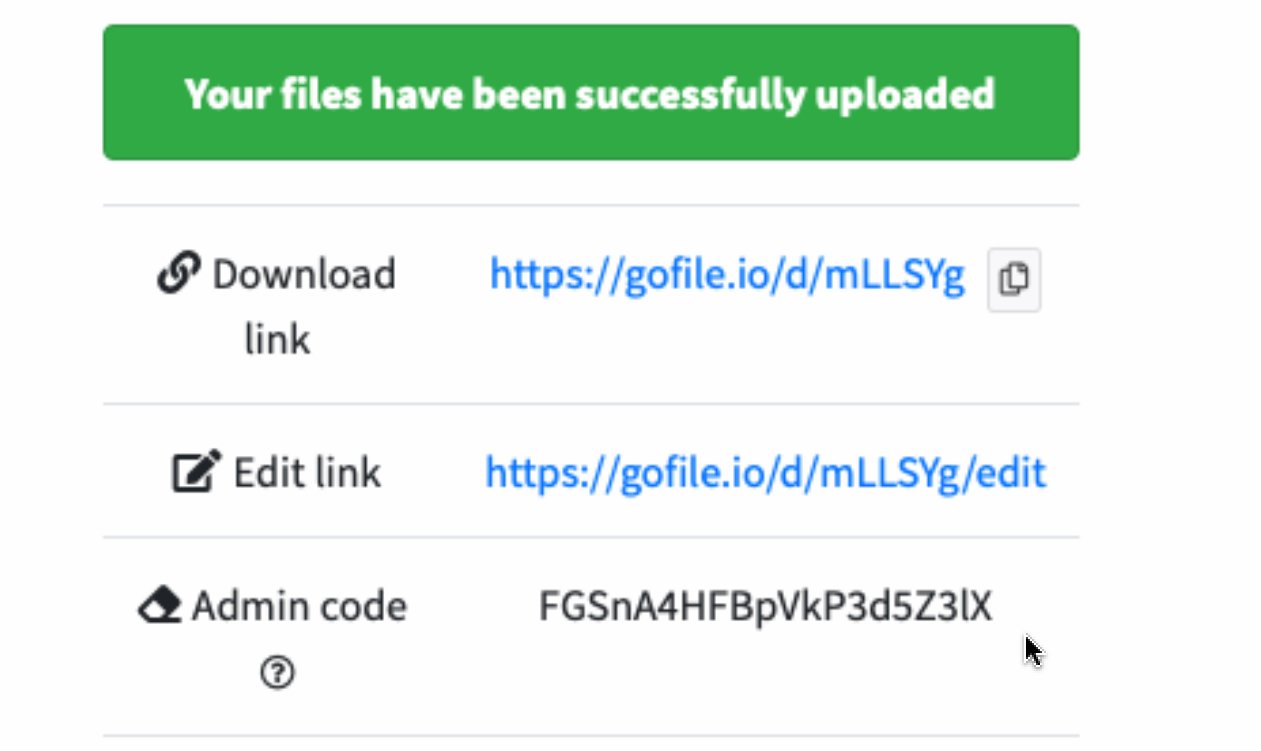

    Did you really enclose a picture of your link, thus making the link itself unclickable?
  19. Sorry i uploaded the file from a headless computer i access with my ipad. I would have just copy and pasted the link, but i dont have the website password to this forum on that computer was being lazy. Next time, i will include the regular link lol.
