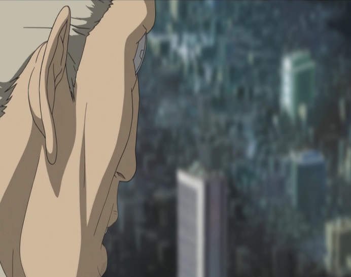

    OK, I may be being a pain, but I needed a thresh of 8 to get rid of this one:
    There's another frame in the sequence that failed to be removed even at thresh=4 - it amounts to just a slight discolouration that isn't even noticeable when looking at just the frame itself. I'd have to post three pictures to show what I'm talking about and so I won't but since I'm sure there must be consequences to setting the threshold that low, much less setting it even lower, I'll just have to leave it there.
    {On the one hand, I may be obsessing over something everyone else already knows, on the other hand, if they already knew, why didn't they tell me when I asked?}
