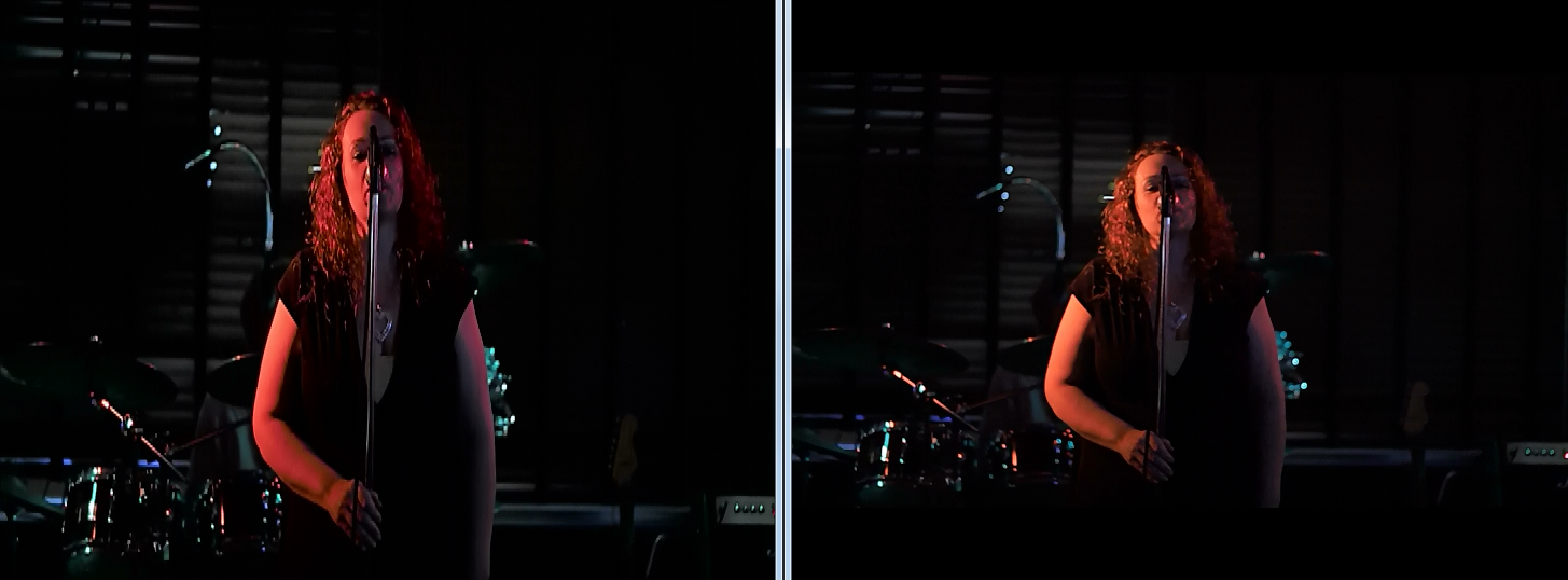

    Here is the results,

    Left = Kdenlive -> Microsoft Windows Live Movie Maker -> Microsoft Windows DVD MAker
    Right = Kdenlive -> AVStoDVD

  12. Why'd you let the Windows program convert it to 4:3, thus losing even more resolution? You sure you didn't reverse the pictures (or the labels for the pictures)?
    Aug 2013
    the previous comparison was not fair since the aspect ratios were different and because even with Windows Live Movie Maker and Windows DVD Maker set to 16:9 output was 4:3 VOBs,

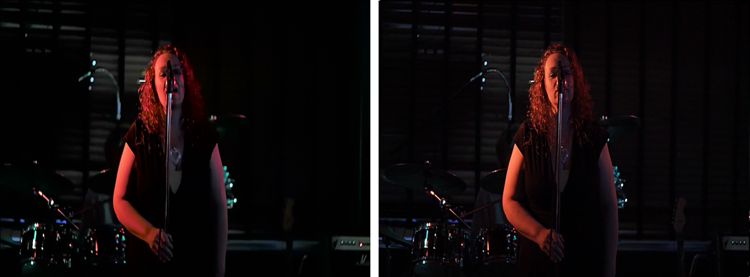

    here is my AVStoDVD now,
    Video: MPEG2 Video 720x480 (4:3) 29.97fps 9000kbps [Video]
    Audio: Dolby AC3 48000Hz 6ch 448kbps [AC-3]
    Left and Right remain the same respectively as in my post above.
    Aug 2013
    Left = Windows DVD Maker
    Right = AVStoDVD
    i have set in the preferences for both Windows Live Movie Maker and Windows DVD Maker to be 16:9, and my source file is 16:9, so i am not sure why it's getting switched to 4:3
  15. Something's not right. The picture on the left is from a 16:9 DVD, you say it's out of the Windows program, yet in your post 11 it says it's a 4:3 DVD.
    The picture on the right is from a 4:3 DVD, you say it's out of AVSToDVD, yet in your post 11 it says it's 16:9.
    OK, now I see you've changed what the AVSToDVD program put out. Again, though, why do anything for 4:3?
    ...so i am not sure why it's getting switched to 4:3
    Obviously you did something wrong. The log would tell the tale.

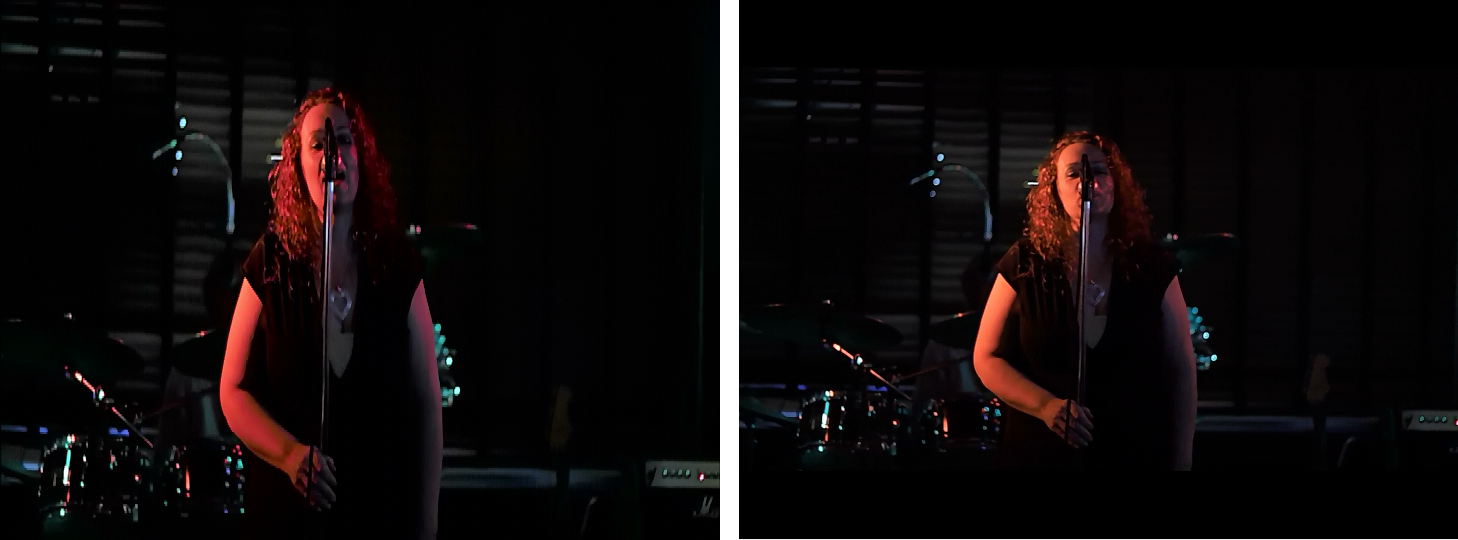

    To confirm (or disprove) open the VOBs in DGIndex and run the Preview. In the Information Panel that opens up it'll tell you. DGIndex is probably included in AVSToDVD.
    Aug 2013
    Here, I got it with DGIndex. Both should be 16:9
    Right = AVStoDVD
    When I zoom in for closer inspection I immediately notice that the AVStoDVD side has a lot more detail
  21. Now you've gone and switched pictures. This time they're both 16:9.
