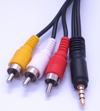

  8. This is the cable I purchased.

  9. Also my problem isn't getting the video to the computer. Its getting the video to show up on my camera. As I've said before the video will show up for a brief second on the camera when I replug the AV cable but then the screen goes blue again. And yes the buzzing occurs when I plug in the yellow chord.

    Read my previous comment again. Try the red end wire in the yellow vcr plug by itself and see if you get video. If not try the white. It looks like the cable you bought is not properly wired for your camera but you might be able to use it if you ignore the colour and manually match the cables yourself.
    You can only mix-and-match and try repositioning the plugs on RCA end of the cable differently if the ground or common is the same on the 1/8" plug end for all and any such 4-way 1/8" mini-plug to male RCA plug cable. But they are not. For any of Sony's D8/Hi8 camcorders, on the 1/8" end, if the tip is 1, then progressively ring 2, 3, 4, the correct arrangement starting with tip is (1)left audio, (2)video, (3)ground or common, (4)right audio. Right audio is the ring on the plug closest to the plastic base, but this is ground (!) on an exact-looking connector for use with a Canon DV-camcorder (which OP presumably bought, which will not work correctly, as he finds out). With that, one can't simply strip and rewire the RCA plugs without a hefty measure of imagination and patience thrown in, on top of dexterity with a multitester, soldering iron, mini-cutter, & heat-shrink tubing. It's tough because there is absolutely no way to know if it's the correct one on viewing a pic of the lot on ebay.
    That cable sure looks allright, i bought several of those for use with my Sony D8 camcorder.
    Also what i read they are listed as being compatble with most (older) camcorders including canon.
    Probably better now to verify the correct working of the cable first by using it for playback from your camcorder to a TV/Monitor.
    If that is verified working then it should work the other way around too.
    Possible then something is wrong with the connection to the VCR (how is it connected)?
