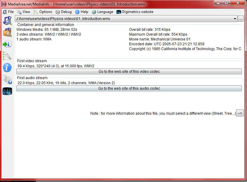

    Here in the attachment is the detail of one of the videos.

    Please see the attachment

    Those Mediainfo shots say you have a WMV2 file.

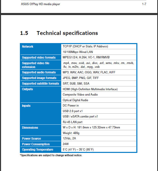

  11. In fact, the manual page the OP posted shows the O!Play only supports "MPEG1/2/4, H.264, VC-1, RM/RMVB". So WMV2 is out.
