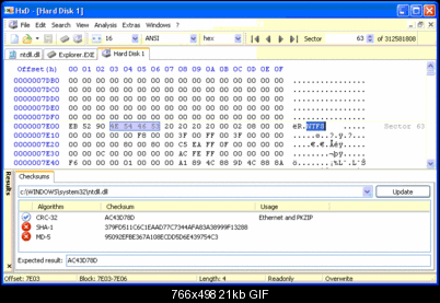

    Open in a Hex Editor (like HxD) and do a print screen of the readout. Like this:

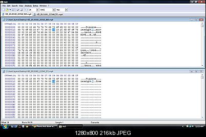

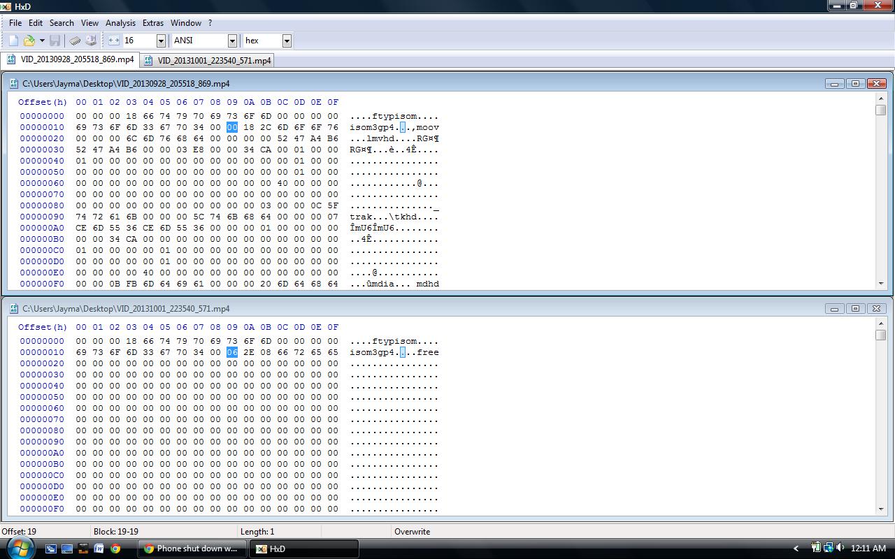

    Not sure if this is what you mean? the top is the known good file, the bottom is the bad file.
    There IS stuff there, it's not just all 00, but you do have to scroll quite a bit to get to it.

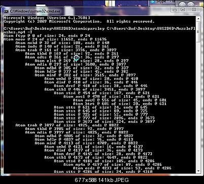

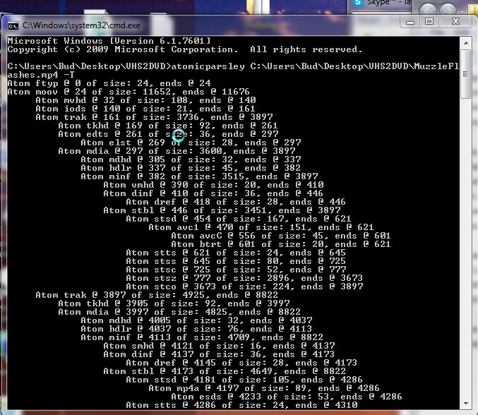

    The area after "free" in the second example means an area with nothing in it but you need to see if if structure and data is corrupted. Looks like an MP4 so download
    Atomic Parsley and run the command line "AtomicParsley /path/your.mp4 -T" This will display something similar to:
Name:	ScreenHunter_34 Oct. 05 21.01.jpg
    Look for errors. If you are lucky, you can recover from one of the services mentioned. The reason most charge is that MP4 files are particularly hard to recover manually
    because the "atoms" are all linked together and so are their byte counts.
    If you are not lucky, you will have a whole file of "free" hex 00 and that's equivalent to nothing. The 062E08 in front of free means 405000 bytes of free so hopefully
    there's the rest of your 230 MB of data.
