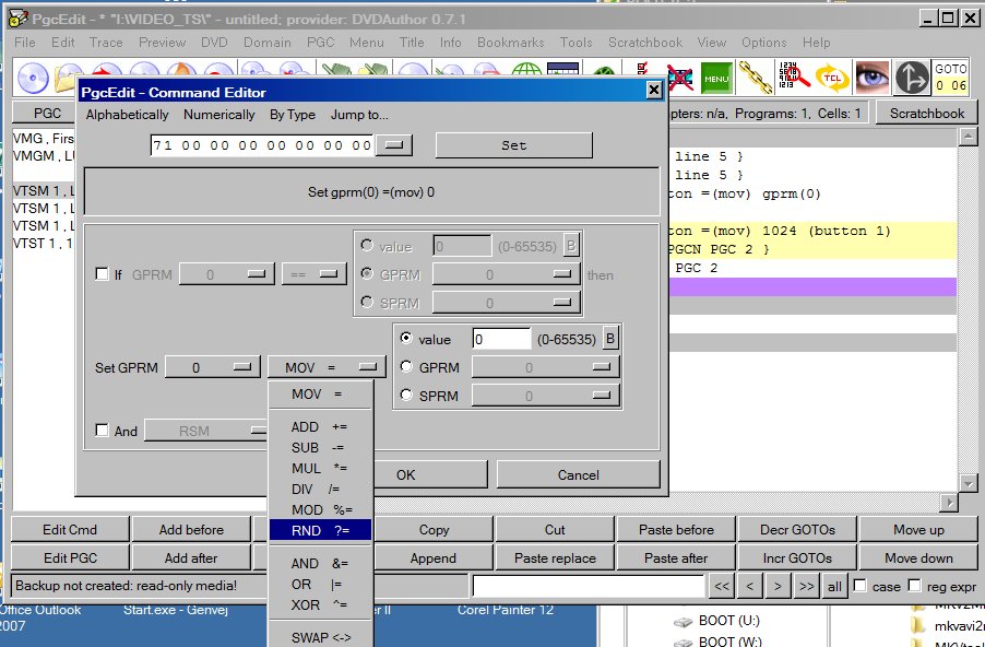

  21. AND I just tested PGCEdit and could not find command with random generator also
    It's here:
  22. ok, cool , it is RND then , for some reason I thought it is rounding up function or something ...
    it can generate numbers directly, like RND(3) will generate three numbers 1, 2 and 3

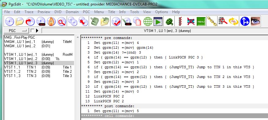

    DVDLABPRO creates this to jump randomly into three movies:
