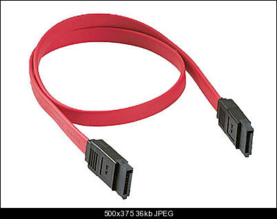

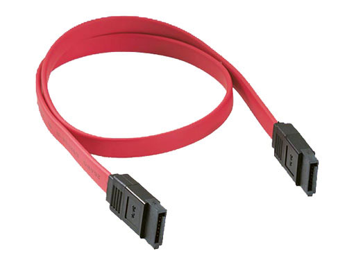

    You will need a SATA data cable, which looks like this:
Name:	sata data cable.jpg
    The drive may not come with a data cable, so get one when you order the drive.

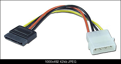

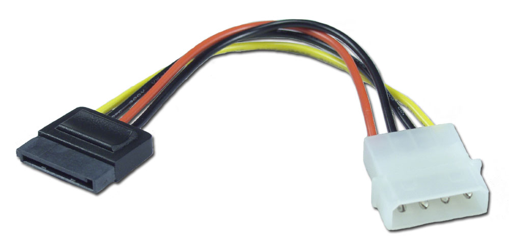

    You will also need a SATA power connector. Your power supply probably has one free already, but you can order a molex to SATA power adapter if necessary. This is what the adapter would look like:
    If your power supply has one free, it will look like the black end of that adapter. You need to check to see if there is a free one that will reach the new optical drive before ordering anything.
