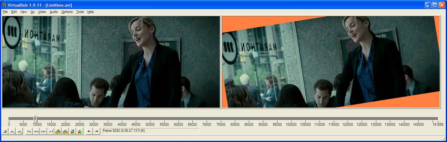

    Make sure that "View -> Output video pane" is ticked
    Mar 2008
    The "After" image should show up in the right pane:

    Ah I feel quite stupid now!!!
    The output video pane was ticked....however the other window was behind the first pane, which I stupidly didn't realise.
