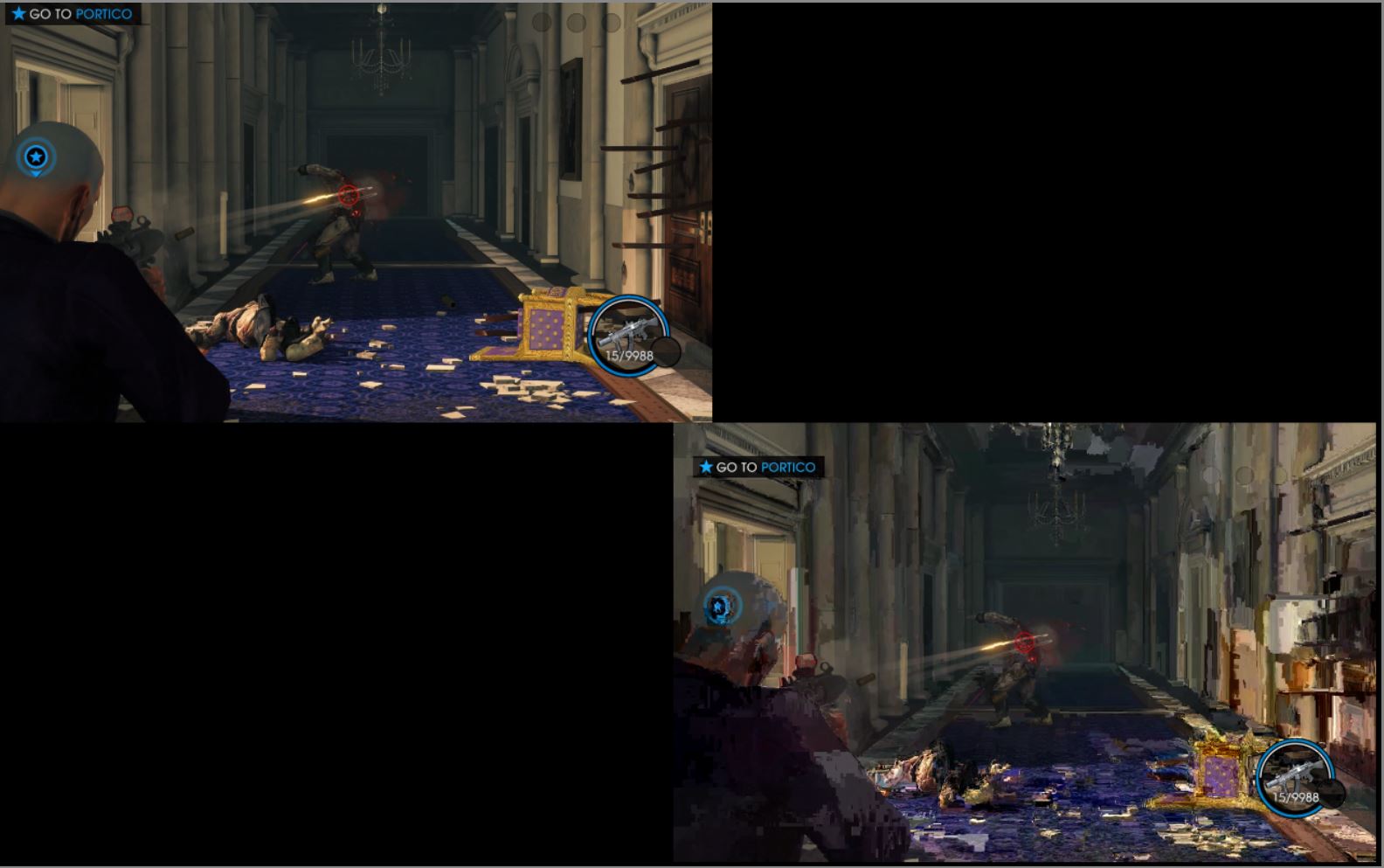

    Video in Windows Media Player Classic:
    Video in Sony Vegas:

    I took a test video of Saints Row IV that was HORRIBLY choppy in Vegas/Premier and imported it into VirtualDub and did what you recommended - compressed it using Lagarith Lossless Codec (originally recorded as RawCap with x264vfw codec and then built as AVI using DxTory) and "Saved As AVI". I imported the newly built AVI into Vegas and it is CRYSTAL CLEAR! WOO HOO!
    I thought I had lost over 150GB of footage but it can now be "salvaged"!

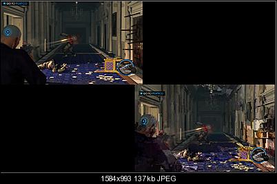

    This is a screenshot inside Vegas showing BOTH the original AVI (x264vfw) and the new AVI (Lagarith):
    [The original AVI file was 915MB and the new AVI is 8.21GB]
