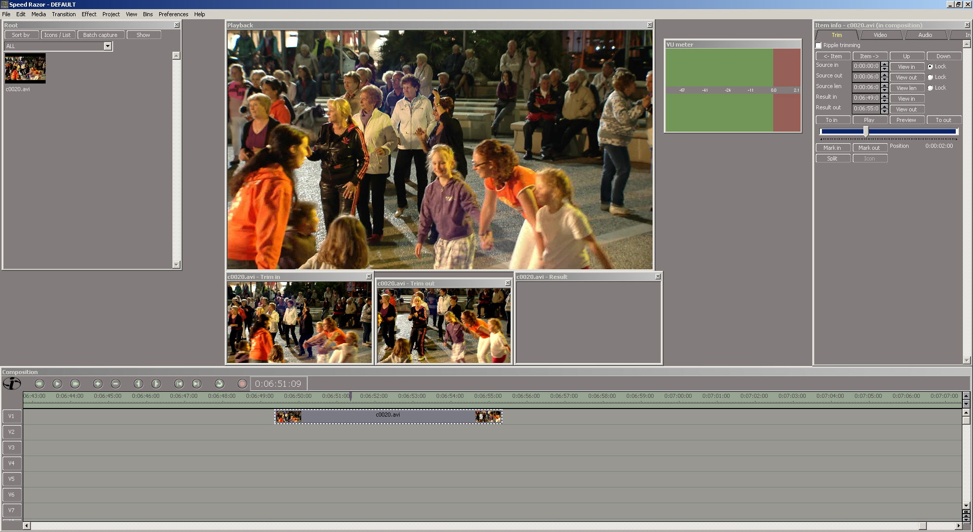

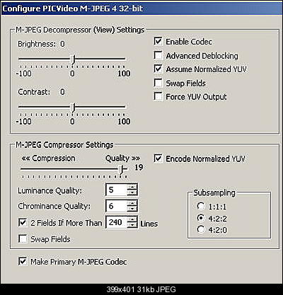

  10. Click image for larger version
    Is not possibile because it does not support natively Mpeg2. It have a plugin (mjpeg_avi.rzf) that can manage directly only mjpeg format... it's an old but powerful NLE. Unfortunately the software-house (In Sync) manufacturer has closed just before release hd-version.
    It have a brother: Blade 2.2 that can import also .mxf and mpeg2 but the external call to vfw files causes many problem of jerky playback and other problems.
    Speed Razor 5.51 and Blade 2.2 can only manage directly mjpeg .avi files: I have do a series of test with .mjpeg using matrox .mjpeg and PIC .mjpeg video codec: at the best results the quality is 99,9% the original files.
    If I transcode a .mxf avi source with the PIC mjpeg I achieve in mjpeg practically the same quality even if the disk size is 200% greater the source.
    By many and many tests I conducted with broadcast monitor I can say that the loss of quality is absolutely not visible to the naked eye: using PIC mjpeg if the quality ratio is 19 the quality of transcoded video is 99,9% the same.
    I can tell you that in this case the loss of quality is absolutely non-existent.
    If you do not believe try to use the pic exactly as I have configured and compares the source and destination in a HD broadcast monitor: without knowing during the switching you will not be able to distinguish the origin and destination.
    My problem is this: transcoding in .mjpeg I used blade or virtualdub but for practicity I need to use a command line system.
    My question is: I need use FFMPEG to achieve the same results (c0020.avi) of virtualdub. When I open a file generated with virtualdub is all ok, but my nle don't open files mjpeg generated in FFMPEG, maybe because it don't do the progressive

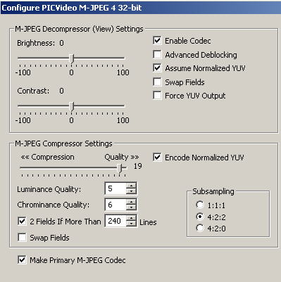

  18. I have try this:
    ffmpeg -y -i c0020.mxf -vcodec mjpeg -pix_fmt yuvj422p -b:v 50M -an -vtag MJPG testout.avi
    Next passage:
    load the testout.avi (in my system the default mjpeg codec is "pic mjpeg codec v.4"), set No audio, direct stream copy and savi to avi testout2.avi
    import testout2.avi in Speed Razor: not readable
    Header of testout2.avi seems ok but file not readable
  30. My question is: why with FFMBC I achieve a correct video mjpeg/.avi and with FFMPEG no?
