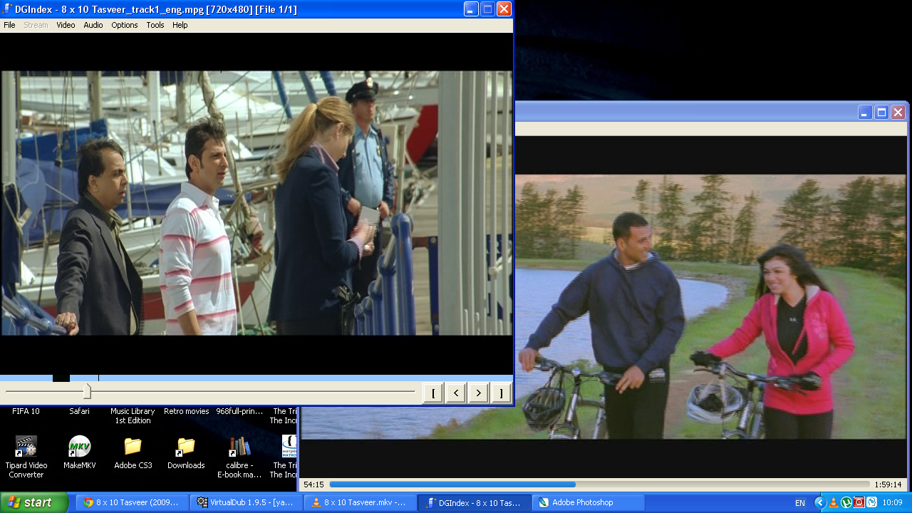

    Guys, I have just started encoding another movie, and I have encountered something I never experienced with bol radha bol. This time the aspect ratio of the movie is 2.35:1.
    Take a look at the screenshot, when I import and ouput the movie in DGIndex, it narrows it for some reason. So by the time I put into virtual dub I have a picture that is shorter by width. On Bol radha bol, it only changed by height, which was easy to fix. But is there anyway of outputing from DGIndex so that it maintains the proportion of the movie?

  26. Originally Posted by Acehit View Post
    No it doesn't. DGIndex is showing you the way it's stored on the DVD, 720x480, just as Bol Radha Bol. In this case the DAR is 16:9 whereas Bol Radha Bol's was 4:3.
    What's the intended final output? If another DVD you keep it at 720x480 and encode for 16:9. If you want square pixels for something then crop away the black and resize to something like 640x272 maybe.

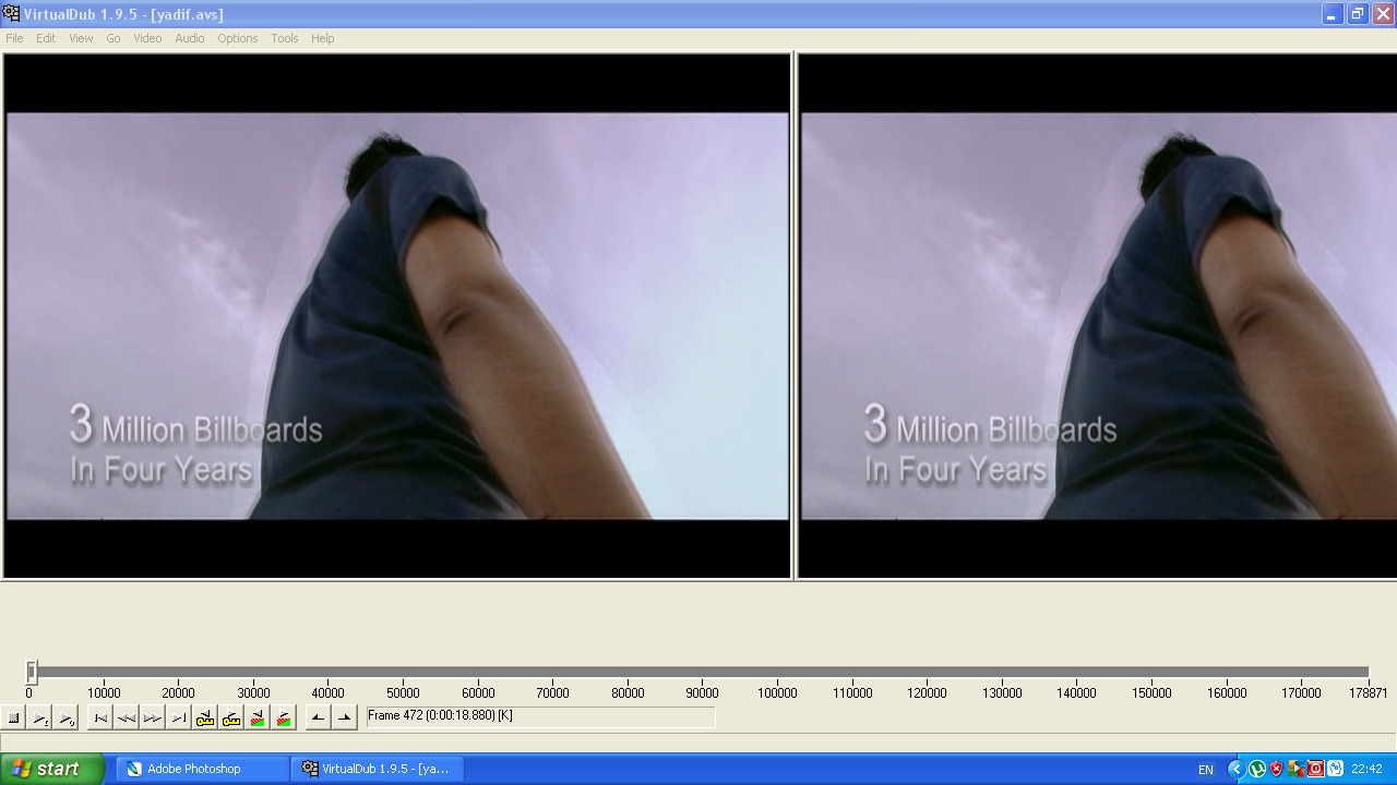

    Guys, check this screenshot. This new video is a much better picture quality then the last one as its a more recent movie, but during scenes of intense motion, the blur that you get from de-interlacing or whatever it is has reduced to this. A very faint edge halo. Now I could use qtmc but since I do not have the horse power to run that, are there any additional filters I could use to eliminate this? If not it's no big deal, you don't notice it anyway, but if there is an easy way to get it 100% clean then I'd like to know.

  28. Why do we have to tell you again that pictures are next-to-useless? Post a video sample. 10 seconds with steady movement will be plenty.

    Here it is, the reason why I didn't upload this initially is because with a screenshot I can exactly show you what I mean.
  30. Is that the source or your conversion? You need to provide a sample of the source if you want help figuring out what's wrong.
