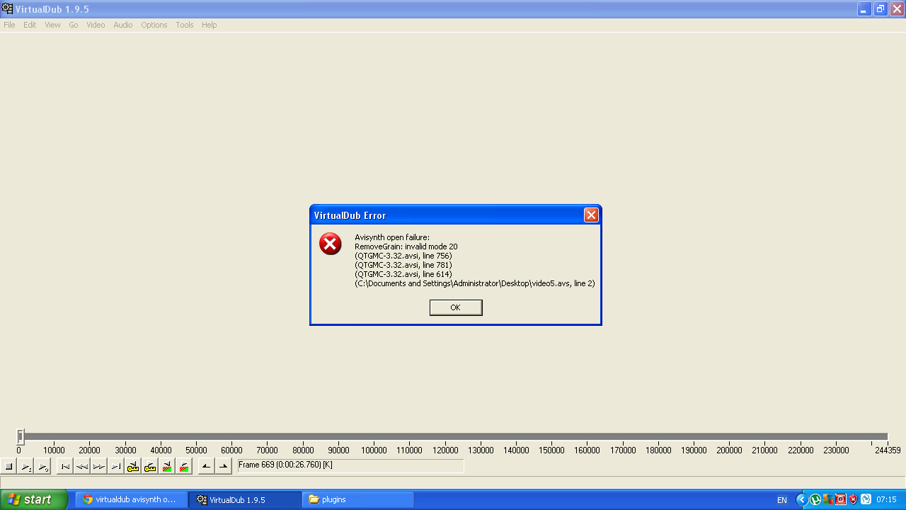

    Guys, I am getting the following error message when I load the script. I googled this to see if I can find a solution, apparently I havent got the correct removegain plugin, but I did copy everything that needs to be copied from the folders, what am I missing here? pls see attached.
    the script i am using is:
    MPEG2Source("C:\Documents and Settings\Administrator\Desktop\video.d2v")
    QTGMC( Preset="Very Fast", Sharpness=0.75 )
    sRestore()

  8. You're using the wrong version of the RemoveGrain.dll. See if this one works:
    Aug 2010
    Leicester, England
    Tried it, still exactly the same error message. What's with the remove grain man, there's gta be a way round it. I googled it and it seems to be a common problem. Can't find a solution though. pls see attachment, these are all the plugins I have in my folder. Anything no seem right?

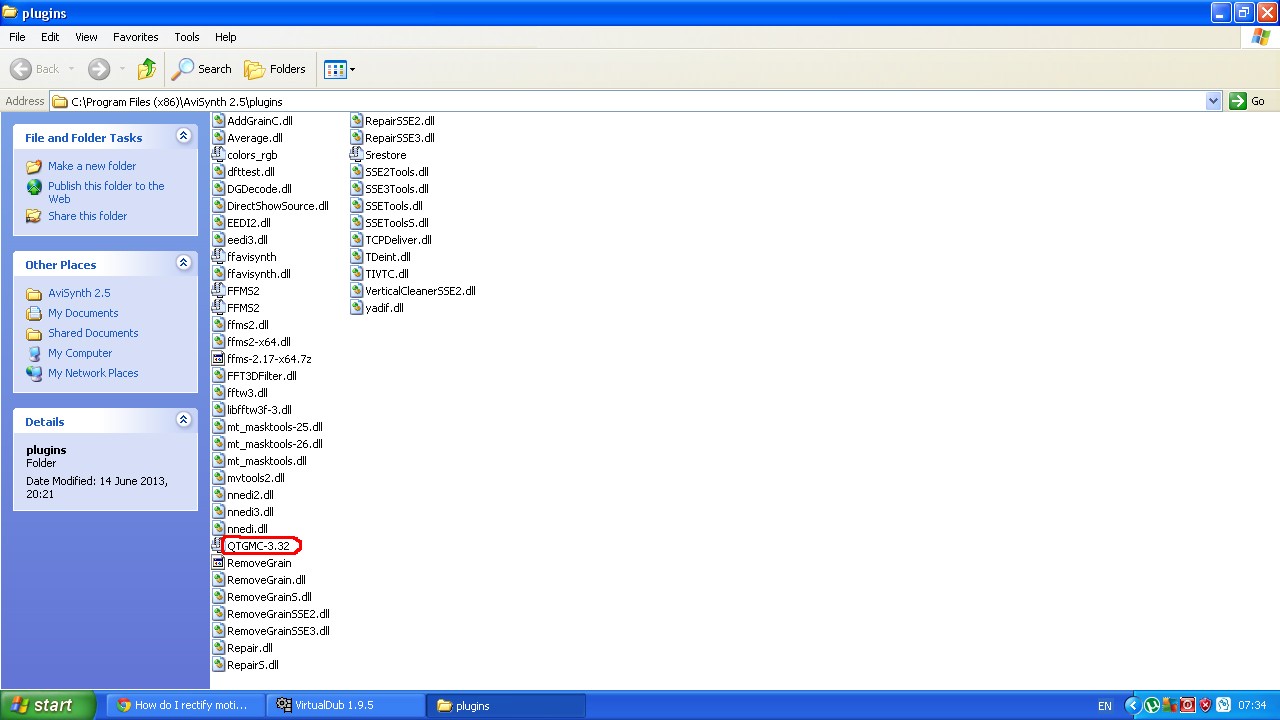

    Aug 2010
    Leicester, England
    sorry here it is.

  11. Sorry, I found that ZIP file of it and assumed it was made from the RemoveGrain.dll I use for QTGMC. After checking the dates for the two versions, they didn't match. I hope this is the right one. Again, I apologize for wasting your time:
    Aug 2010
    Leicester, England
    I appreciate your help, still no go. same error message. Did you check my filters folder? Does everything seem ok in that department?
  13. Darn. I didn't pay your filters folder much mind, no, as the original message specifically mentioned RemoveGrain. OK, two more suggestions. The first is to get it from the Plugins Package or the Modded Plugins Package (or even the new(er) plugin pack for AviSynth 2.6) of needed DLLs in the first post on the QTGMC page:
    http://forum.doom9.org/showthread.php?t=156028
    The other is to try the versions on the RemoveGrain page of the AviSynth wiki until you find one that works:
    http://avisynth.nl/index.php/Removegrain
    Aug 2010
    Leicester, England
    You Don! Suggestion 2 worked! I am running a test now on virtualdub. my goodness is this slow though! It uses up the entire power of my pc!

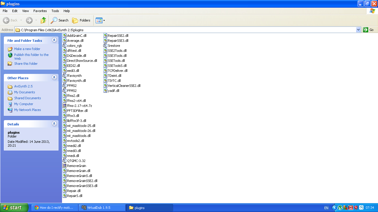

  18. It's in that same plugins folder, QTGMC-3.32, but without an extension listed for some reason. You can open it in Notepad to read the contents. Maybe it's an AVS and not an AVSI.

    Bud, I still can't see it. in that folder is sub-folders in sub-folders. Do you have an example of a small test comparison between yadif and qtmc? It looks like to me whatever the difference is incredibly minor and barely noticeable. Especially if you're watching the video from a reasonable distance there's no way you're gona notice.
  20. Someone else might remember where a deinterlacer comparison is. Anyway, in that plugins folder you uploaded earlier is this:
