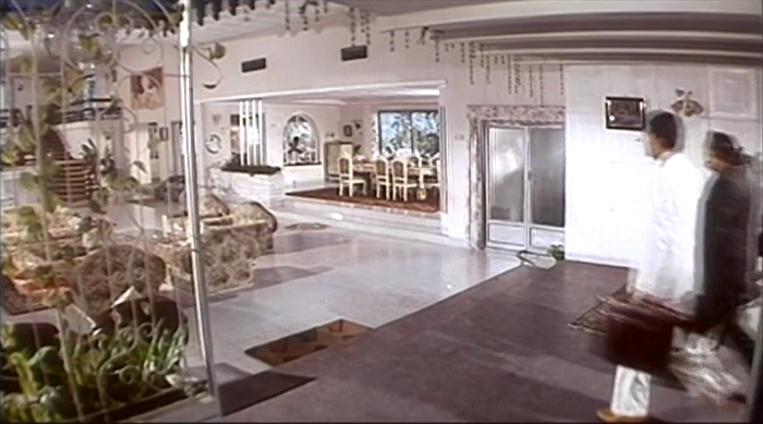

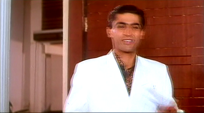

    Does anybody have a solution to this? Basically I have converted a whole bunch of dvds to mkv using a software called 'makemkv' and what I have realised after all this time is that the output files have motion blur during scenes of increased movement. If I had known this earlier I would've never converted them to mkv, I would've just ripped the vob files and kept them untouched but now that I am in this situation, does anybody know how to remove them completely?
    I am using handbrake to make the files smaller, but even by selecting the decombe filter and experimenting with the deinterlace filters, it wont get rid of it 100%. The 'slower' setting on the deinterlace filter will reduce it by a great deal, but I am looking for a way to just get rid of it completely.
    Anybody know of any other software or any solutions?
    I have tried converting them back to vob files, but the blur still follows through.
    Please see the attached files so you know what I mean.

  2. It looks like they were blend-deinterlaced. It's not motion blur. Do you have a short sample you can make available? Pictures don't really tell us much. And I take it the DVDs aren't available any more? MakeMKV doesn't reencode so the blending didn't come from it, Maybe it was already in the source DVDs. In any event, the chances are the damage can't be reversed.
    Now, if you're taking pictures from a player that's deinterlacing the MKV, there's hope. If the MKVs are still interlaced they can be unblended successfully. But not with Handbrake. Only AviSynth can do the job and Handbrake doesn't use it.

    Anyway, this sample is much better. It's field-blended and interlaced. It has to be unblended using an AviSynth script, one such as:
    Yadif(Mode=1)#or the better and slower QTGMC
    SRestore()
    It came from what was originally a PAL source and the result will be a 25fps video. You can't do this in Handbrake but some program that accepts AviSynth scripts as input. The linked video only unblends it. It doesn't address any of the other problems with the movie, such as the shaky picture, the edge enhancement, or the severely blown-out whites.

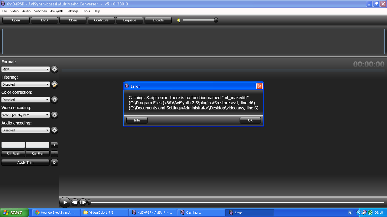

    Ok here's where i am. I have attached the script that I am using and the error message. I am missing something. I get the same error message with virtual dub.
