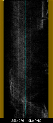

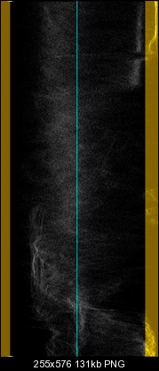

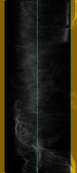

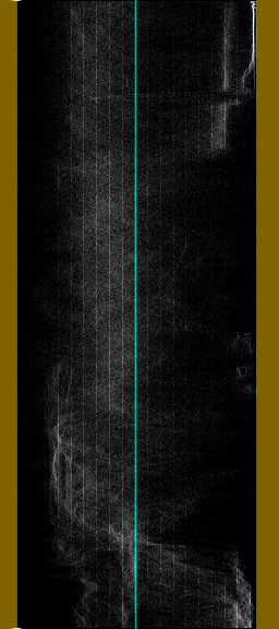

  11. I tried
    Levels(0, 1, 255, 0, 235, coring=false)
    and contrast is normal now, but there are some vertical lines in the waveform.
    This is without the levels correction:
    And this is with levels correction:
    Those vertical white lines, ar they indicating a problem ?
  12. You're reducing 256 integer values to 236 integer values. There has to be some duplicates in the result. That's what those lines are. You can use SmoothLevels() instead of Levels() to add a little dithering to the results. SmoothLevels() is part of the SmoothAdjust package.
