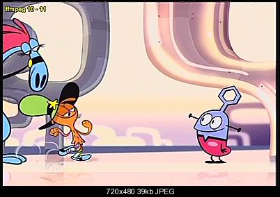

  3. I was able to read avs2yuv.y4m with RawSource() with no problems. ffmpeg.y4m worked after the fix I used earlier.
    RawSource("ffmpeg - fixed.y4m")
    My rawsource.dll is dated 7/28/2006. It's 73,728 bytes.
