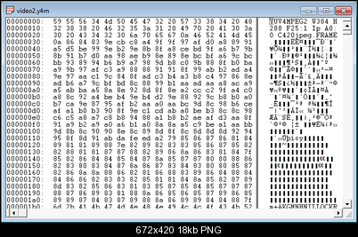

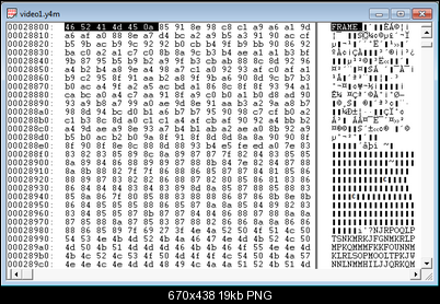

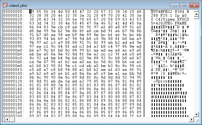

  14. Originally Posted by vhelp View Post
    ffmpeg -i video.avs -an -pix_fmt yuv420p -f yuv4mpegpipe -y video3.y4m (doesn't work)
    ffmpeg -i video.avs -an -pix_fmt yuv420p -f rawvideo -y video3.y4m (works)
    So the difference is the first command produces a raw YV12 video file with a Y4M header, the second command produces simply a raw video file. You can clearly see the Y4M header in a hex editor:
    The first four lines is the Y4M header. The rawvideo command doesn't include them. Also each frame in the try Y4M video has "FRAME(0x0a)" at the start of each frame:
    In short, the first command produces a true Y4M file, the second command produces a raw video file. And RawSource() doesn't understand the Y4M header that ffmpeg produced. ffmpeg's header includes more information than the Y4M sample I was working with:

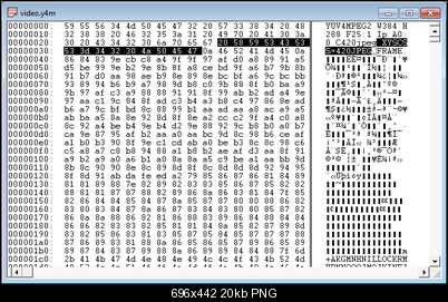

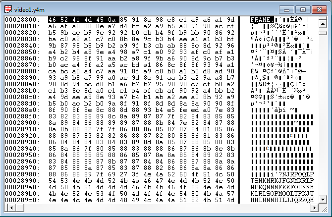

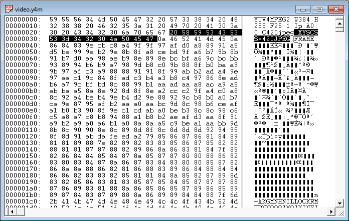

  23. Originally Posted by vhelp View Post
    great. or else.. is there anything i can do to the .y4m files.
    You can use the hex editor to cut out unneeded parts of the header. For example, mark a section like " XYSCSS=420JPEG" and cut it out (Edit -> Cut, or press the Delete key). Then File -> Save.
    Before:
    After:
    That should now open with RawSource().
