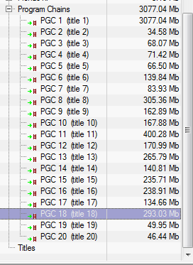

    I have dvdremake on my computer(if this helps here is a screen shot)this is one of the program chains:
    The movies are on PGC 18, 19 & 20
    As you see they are apparently separate files.
    Name:  program chains.PNG

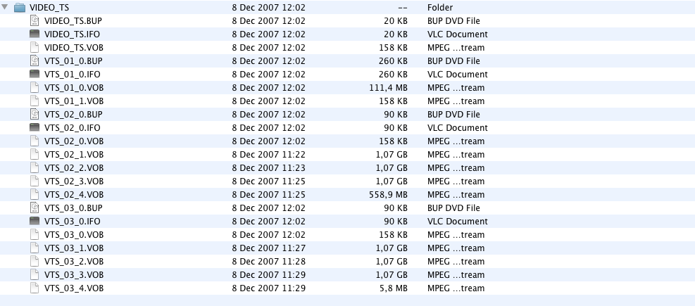

    Looking(good) at the dvd again. I realized there are 11 languages. And apparently a dvd program(like encore) allows 8 audiotracks.
Name:	screenshot encore.png

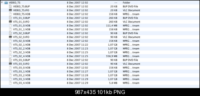

    So the dude that made the dvd(i assume) needed to make a copy of the full movie to add the 3 extra audiotracks.
    This is my original content(for NTSC and PAL it's more ore less the same). I wont be mixing them

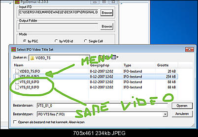

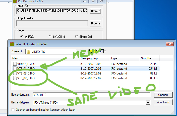

    This when open demux
Name:	demux opening files.jpg

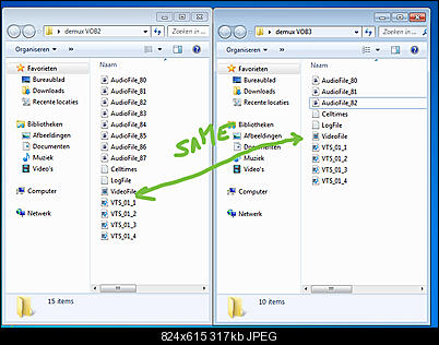

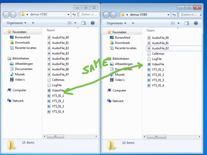

    Output demux:
Name:	demux exported.jpg

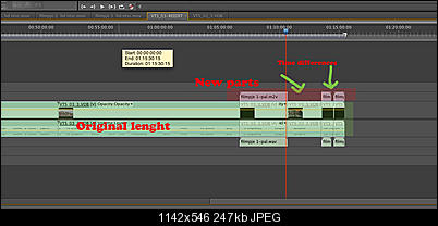

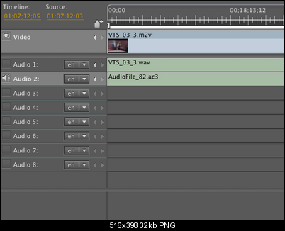

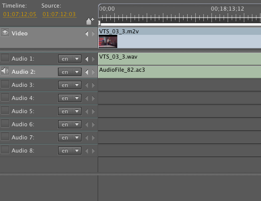

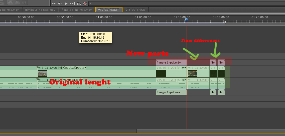

    IMPORTANT!
    This is a timeline in Premiere. On the top the new content is on the old video. However there is some time differences.
    Can i close that gab?
    The new files have a different audio track(it just a song, no voice over).
Name:	timeline premiere.jpg

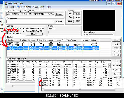

    This is videoblanker when i open the original dvd(pal)
    Hope it a bit more clear now.
