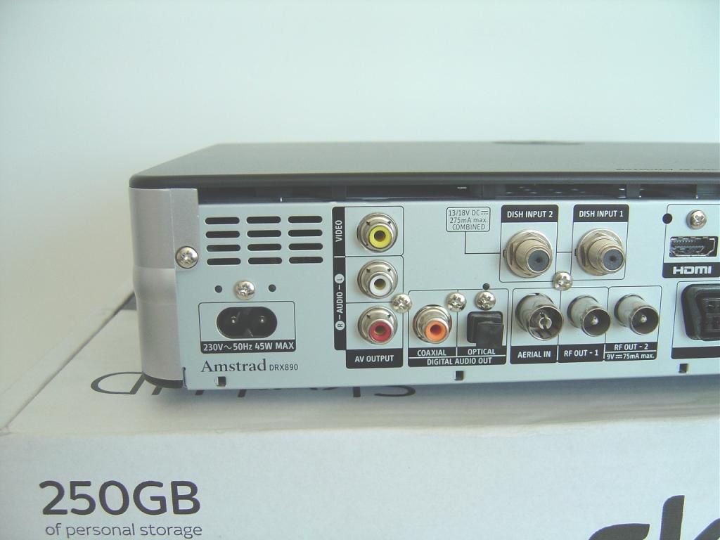

  12. Ok so contacted Elgato and ordered a composite cable,for the game capture HD, i also asked them was there any other cable would i need for it and the reply i had was " I don't know ask our tech support" which i thought was damn rude!! anyway do i need one of these cables as well http://www.ebay.co.uk/itm/like/160792856804?lpid=83&device=c&adtype=pla&crdt=0&ff3=1&f...f13=80&ff14=83 to connect from the composite cable to the sky receiver? ???

  15. but if you look at the cable im buying
    it looks like the same input thats on the back of my receiver
  16. Member DB83's Avatar
    Jul 2007
    No. Why do you think you need another composite cable ?
  17. Member DB83's Avatar
    Jul 2007
    The Elgato adapter is COMPONENT to a/v. It is meant for PS3 not a $ky Box. The connectors on the $Box are composite. Maybe jagabo can explain the subtle difference.
  18. but the inputs looks the same so i thought it would fit so i thought this http://tinyurl.com/omybztf cable one end with the pointy bit would go into the holes of the elgato composite cable and the other end of this cable http://tinyurl.com/omybztf would go into the sky receiver you see, sorry about the pointy bit remarks but best way i can explain it lol
  19. Originally Posted by DB83 View Post
    but it can be used with the analog composite cable from elgato on a sky box they told me and sorry about the reply above i typed it before seeing your reply
  20. Originally Posted by DB83 View Post
    The ElGato component adapter can be used as a composite adapter too. Use the red RCA connector for composite. From the ElGato site:
    Be sure to set the ElGato software to capture composite. Regular red/white/yellow composite cabling will work with that. But, once again, you will only capture standard definition video via composite -- 720x576 in PAL countries.

  21. Member DB83's Avatar
    Jul 2007
    Well if they told you, who are we to argue.
    You can always order the COMPOSITE cable and, yes, the RCA connectors are the same. The issue is the signal carried down the wire and interpretated by the Elgato but, again, you were told it will work so.....

    I was confused since the adapter you illustrate is different to the one jagabo pictured earlier in the thread.
  23. Ok thats fine so ill need one of those cables then so ill go ahead and order it today
  24. Connect the composite output of the Sky box to a TV and see if you get a picture.

    So just to confirm then i definately need one of these cables: http://tinyurl.com/pzzjqug to connect the composite cable from the elgato composite cable to the sky receiver is that correct?
  26. Originally Posted by jagabo View Post
    with one of these cables? http://tinyurl.com/pzzjqug
  27. Originally Posted by jagabo View Post
    Just found one of these cables http://tinyurl.com/pzzjqug in the cupboard and connected it from the sky box to the tv and put it on channel "AV" and yes it works fine
