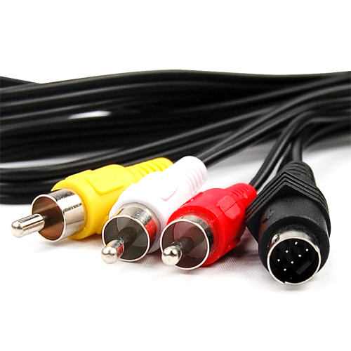

    Now with the cable i just bought (See Here: http://www.ebay.com/itm/150673436362?ssPageName=STRK:MEWAX:IT&_trksid=p3984.m1423.l2649)
    i also have this :
    Would that cable work if i connected it to the elgato and to that connector (see pic) to the back of the sky box?
  20. Member DB83's Avatar
    Jul 2007
    That connector is scart to composite.
    The issue still remains of that a/v connector on the elgato.

  23. The component cable that comes with the Elgato Game Capture HD has 5 connectors: red, green, and blue RCA for component video and red/white RCA for audio. At the other end is a 7 pin mini din connector like the composite adapter you have.
    I don't know if the Game Capture HD can capture composite video (I've never tried it), but even if it can, it's not likely the adapter you bought routes the yellow composite video connector to the right pin on the Game Capture HD. There is no standard for which pins of the 7 pin mini din are connected to which signal at the other end. Every manufacturer does it differently. So even if you find some other 7 pin mini din to component cable there's no guarantee it will work. Get the genuine El Gato adapter.

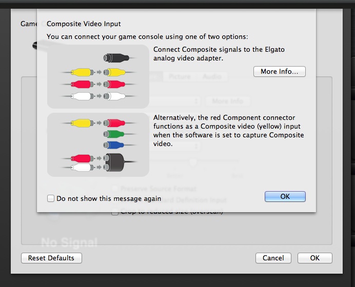

    Saw this for composite:
    http://support.elgato.com/index.php?_m=knowledgebase&_a=viewarticle&kbarticleid=4633&g...englishdefault
    The component cable may work for composite video. Often the green component input is shared with the yellow composite input (because both carry the horizontal and vertical sync).

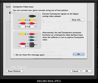

  25. Oh, I just noticed that on the page that shows the composite adapter it says you can also use the component adapter by plugging the the composite source into the red component connector.
    You might be able to use the composite adapter you have. Looking at the 7 pin mini din connector, with the 4 pin row on the top and 3 pin row on the bottom, the signals are as follows:
    gnd, red audio, white audio, gnd
    blue, red, green
    If you have a continuity tester (or a 9V battery, some wires, and your tongue!) you can compare your cable.
    Yes, that red/white/yellow RCA cable will work for composite video -- assuming your SCART adapter is working and the sat box is putting out composite video. Remember, you will only get standard definition video out of composite. S-video is also standard definition but it might give you better quality.
