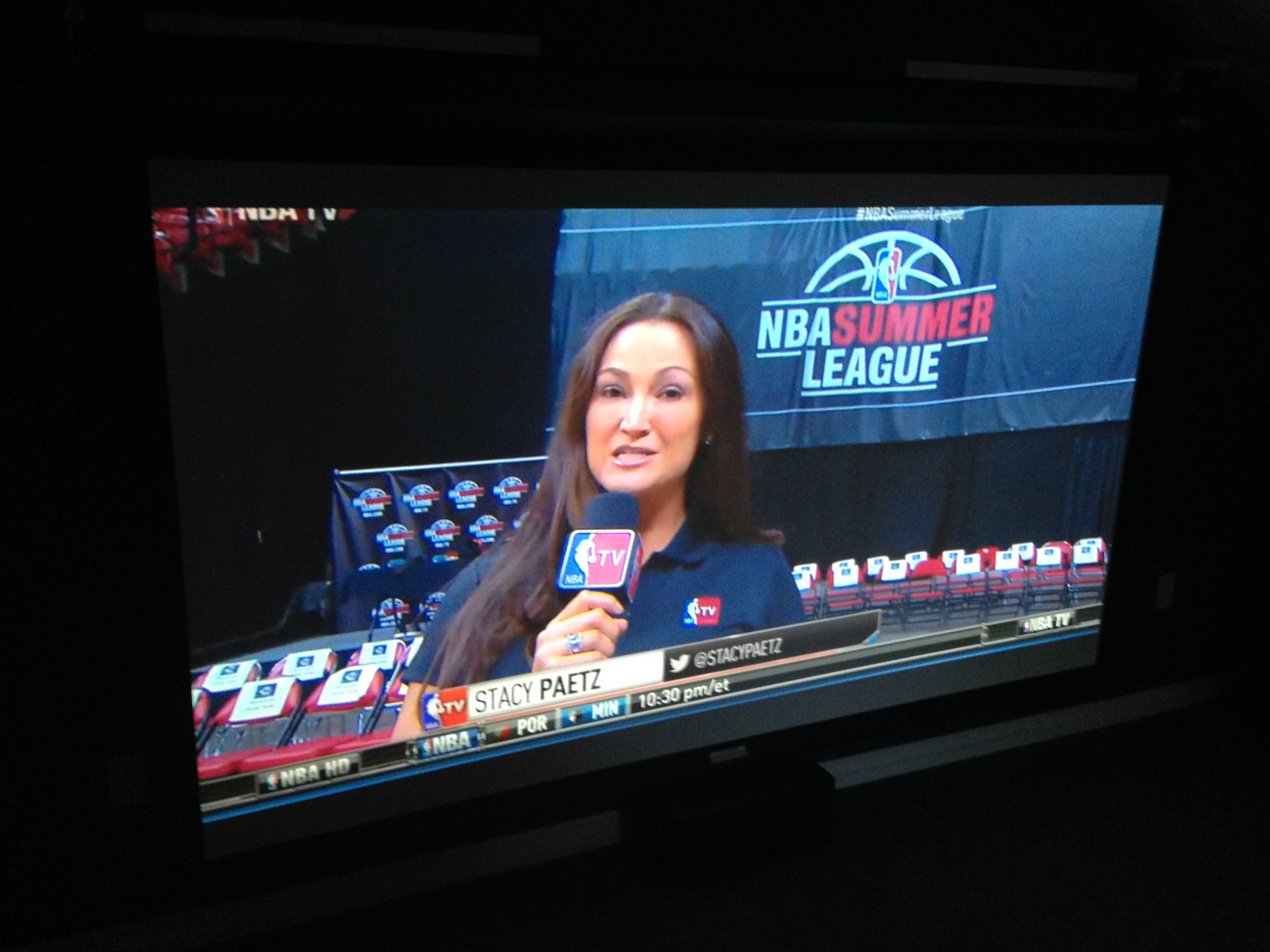

    As you can see the NBA TV is cut off in the top left corner. This happens across all inputs. TV/Bluray/Video Games.
    Specs:
    HD33 Optoma Projector
    Sony STR-DH520
    Sony BDP-S590
    Now I thought at first it was the projector, but after I zoomed it around and adjusted the lens, the cut off still remained. I also believe it does this a bit at bottom too. This is difficult for sporting events where scoreboards are listed at top/bottom.
    Please help me fix this. I don't know where to start.

    I do not know anything about your projector but Sony Tvs have various picture display settings - auto, wide, smart and zoom.
    The first two should show the complete picture. You may have a display setting that does not default to these.

  6. There are at least 30 models of optoma projectors. It doesn't appear they are made by sony at all. As suggested above, check your display modes.

  7. Hey you're right, it appears the projector is an Optoma HD33.
    With my setup I plug the HD33 into the STR-DH520, and all inputs go through there. The Xbox, the TV, the Computer, the Bluray.
    I just tried plugging the computer directly into the HD33, bypassing the STR-DH520. When I change the computer resolution to 1280x720, it fit perfectly. When I do the same when going through the STR-DH520, it does not fill the screen, and things are still cut off.
    I am not sure how to change settings on the HD33. I am not sure how to change the display settings. It appears the problem may be the STR-DH520, which all the inputs are passing through

  9. Yeah, sorry. Everything plugs into the STR-DH520 which then plugs into the projector (all HDMI). No TV, everything projects onto screen on the wall. Sorry, not the TV. I meant the cable box.
  10. Try setting your sources to output 1080i instead of 1080p.
